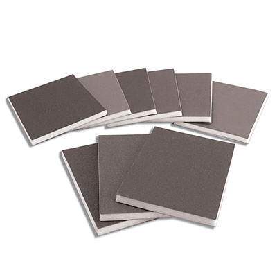

I use this style when wet sanding & polishing. Some people use walnut oil, but think mineral oil less expensive. If using dry will wear out faster.
Micro Mesh: Pen Kit Making Supplies Berea HardWoods
Have never used this style or smaller colored pads.
https://www.pennstateind.com/graphics/400px/MMESHPADS9.jpg
