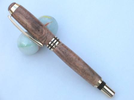

Walnut does indeed turn very well.This is one of many that I have turned and the finish does well also.
