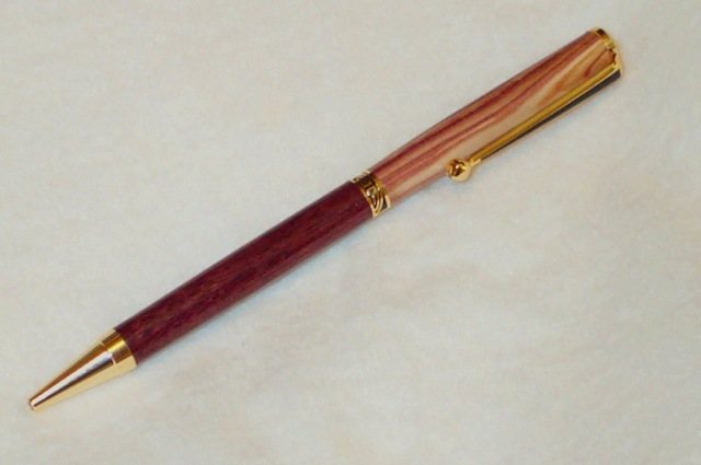

Hi guys, this originally had lilac both top and bottom but I blew the bottom so just used some purpleheart I had. I normally use a CA/BLO finish but with this purpleheart, I kept getting little white areas in the grain no matter how much I sanded with the MM. I went back and sanded it all off and did the sandpaper slurry thing and repeated the CA/BLO finish and there still there!!!! OK, I'm not liking purpleheart at this point. I had the same thing happen with some Ash I turned recently. What am I doing wrong?
