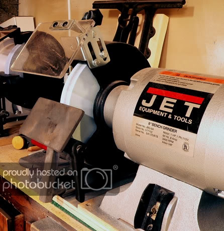

My recommendation would be get yourself a decent two wheeled 8" grinder with white wheels, slow speed if you do flat work, high speed if just lathe work. Add to that a Wolverine jig, make a honing wheel like mine and you will be in sharpening nirvana.
Here is a pic of my grinder with the Wolverine platform for skews.

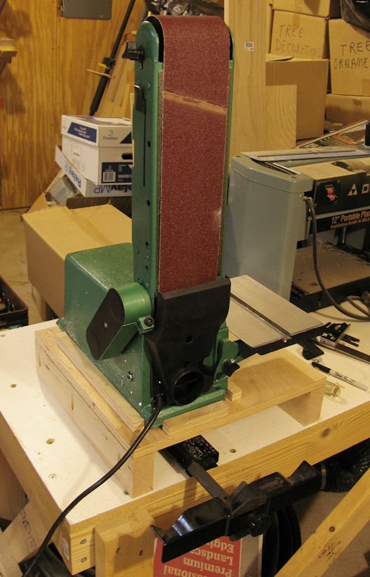

Ken; Using a grinder on a skew produces a "hollow grind" but I prefer to do a flat grind on my skews and other chisels.
I use a belt sander with a Wolverine Jig and Skew attachment to sharpen my tools. The advantages are they don't dig in and you can sharpen them without "bluing" the edges. I was leary about the belt turning toward the sharp edge, but it doesn't seem to be a problem.
I diamond hone between sharpening.
