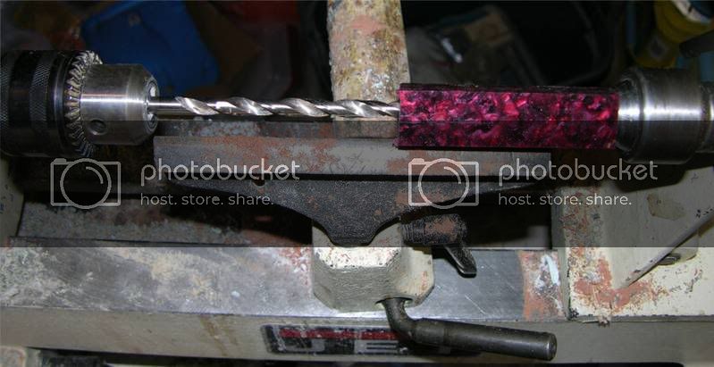

Drill press? We don't need no stinkin' drill press!

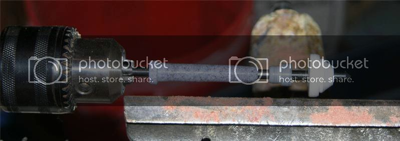

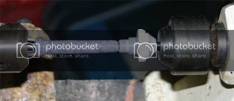

And I ain't got no fancy Beal Colletts and Chuck so I'm using my handy-dandy jacobs chuck. Works right nice for mandrels that vary from the size of my plain ol' $10 MT2 mandrel
And I ain't got no bushings for these Pelikans 'cuz, well, they don't make no such thang. So I made my own from Corian. And since these pens are old and crumbly (kinda like myself) I made an extra long bushing to support the inside of the pen body.

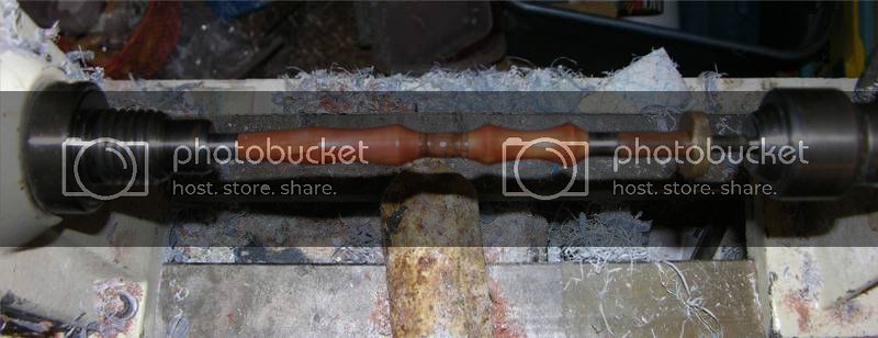

Where I'm from we use EVERY part of the hog! That trains us that ain't nuthin trash. Even that busted pen barrel - that ain't trash that's a spacer!

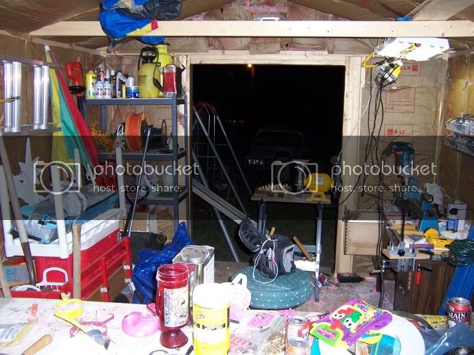

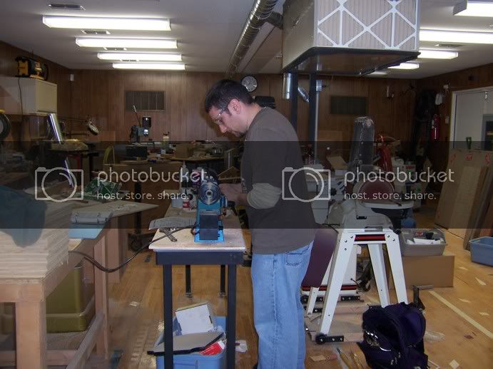

I feel like we must be related. My shop is just about as low budget as yours!
Here's my first workbench:
Then I moved to my shed. Here's the shop, back when it was clean:
Before I bought a 4 jaw chuck:
Occasionaly I get to work here though (half the shop shown):
Do the best with what you've got, that's my motto! Glad to see there's still some of us who make do.

Ok, I'm new to turning. I understand the Jacobs chuck, what's holding the right hand end of the blank? It looks like a live center. What keeps it from spinning?
Yep, I hold the blank against the tool rest with my left hand while I crank the handle in the tail stock which lets the live center push the blank forward along the tool rest and into the drill. If you just try to hold the blank by hand and push it forward without the stabilizing force of the tail stock live center, the blank will wobble on you.
That ain't good. You don't want your blank wobblin' on ya.
The jacobs chuck has to be shoved into the headstock firmly. If not sometimes it will pull out as you're moving the blank back off the drill bit to clean out the shavings or whatever.
(And, Loyd, I'm a she)
Originally posted by jtate
<br />Yep, I hold the blank against the tool rest with my left hand while I crank the handle in the tail stock which lets the live center push the blank forward along the tool rest and into the drill.
I see now, at first it looked as though the blank was clearing the tool rest. Was wondering why you didn't move it out of the way [:D]
Thanks

I'd be a bit nervous holding on to that blank to keep it against the tool rest. Makes my hand hurt thinking about how things could go wrong. I'm all for making do as much as possible, but that just doesn't look very safe to me. Just be careful.
<br />Yep, I hold the blank against the tool rest with my left hand while I crank the handle in the tail stock which lets the live center push the blank forward along the tool rest and into the drill. If you just try to hold the blank by hand and push it forward without the stabilizing force of the tail stock live center, the blank will wobble on you.
That really does look kind of dangerous. You should look into a mini-chuck to hold it for you. Even the cheap ones from PSI would be fine for drilling blanks.
Be careful...

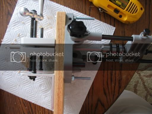

<br />Do you mean a chuck to hold the blank on the tail stock side or to hold the drill bit on the head stock side?
When I drill with my lathe, I stick my jacobs chuck in the tail stock (holding the drill bit), and the mini-chuck at the head (holding the blank). It really works great for accurate drilling.
