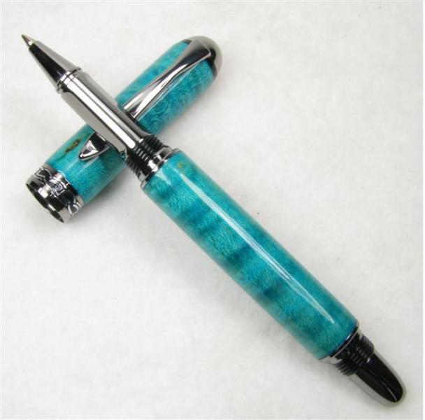

For quilted or curly pieces, I prefer to double dye. I learned most of this from BryanJon; he was a big help. Here is my procedure:
* Finish shaping the piece, leaving it oversized by about 10-15 thou.
* Apply a light coat of black dye, just enough to put the color down
* Let dry overnight
* Sand with 220 until the black is only left in the bottom of the curls. This is where I sand down to the final dimensions of the piece, and go all the way through the micromesh.
* Apply the dye that you want (maybe red)
* Let dry overnight
* I like to sand with the last 3 or 4 grits of micromesh if the quilt or curl is strong enough. I puts a nice highlight on the piece.
This pen looks much better in person. The picture does not capture the depth very well.

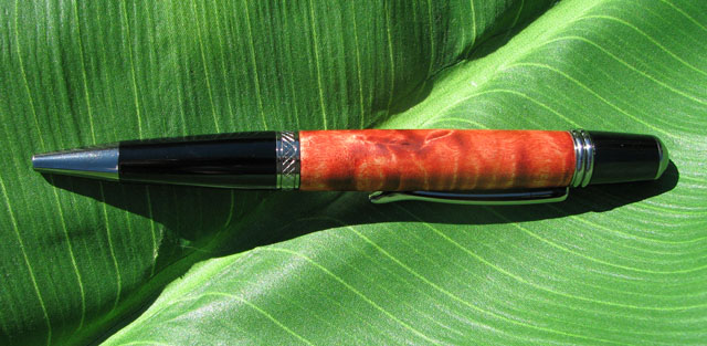

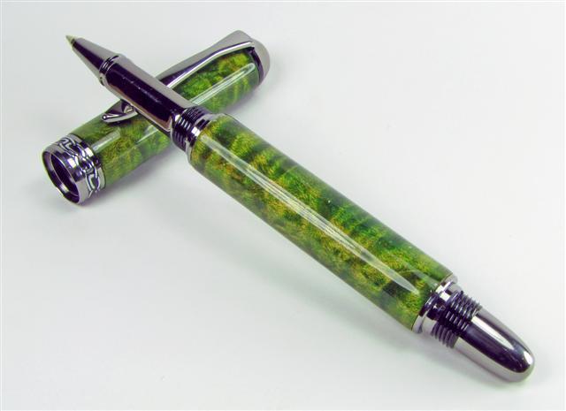

Are these anything like what you are attempting to achieve?
Yup, except probably a more natural looking color, like an antique maple.
The blank has some curl, but it's not as pronounced as it had appeared when the blank was whole. I just want to give it a little contrast to bring out the figure a little more. I don't know if just BLO would be enough to do the trick. I guess I should try a sample piece before doing the turned pen. I've used the dye (Trans-tint) in flat work, but not on a polished surface before, so not sure what to expect. Seems like it ought to work fine.
