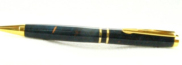

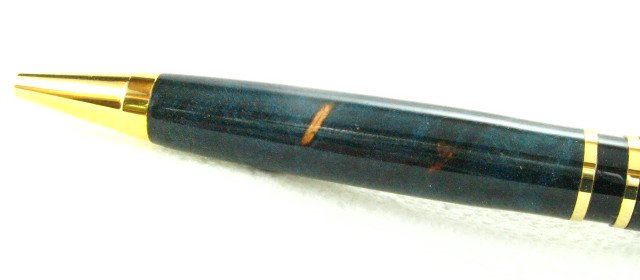

I'll post a pic anyway. I think it came out pretty nice.
with that small of a gap you shouldn't be able to tell unless you were looking for it. glad it worked
I'm glad it worked and I'm really glad it wasn't something stupid like I did. Oh well, I live and learn and I sure don't mind laughing at myself!
Here's the pics.
