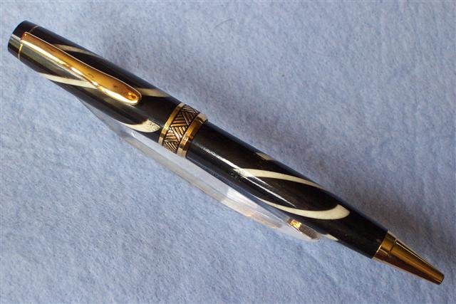

Maybe I was just lucky.I made this one over a year ago.Ed Brown I an I disscussed water buffalo cracking and his t heory is the sprials cut into this one stopped any movement,
