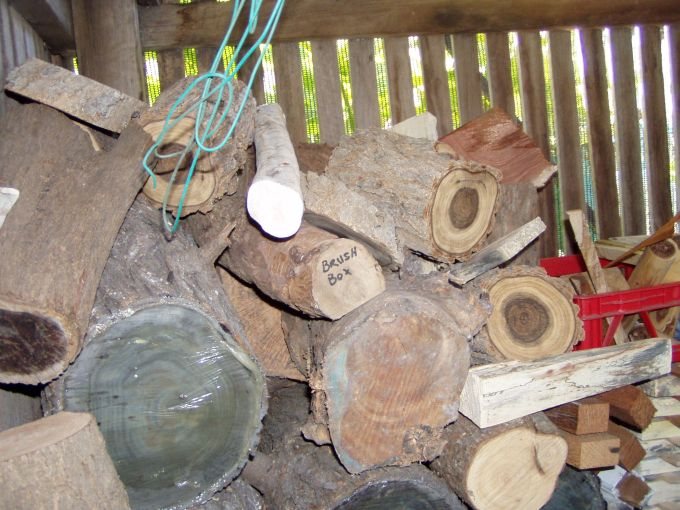

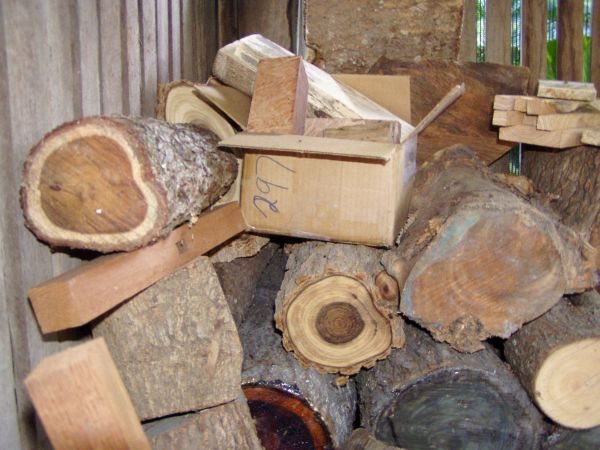

Well for myself I store in form of small log and cut the blanks when needed, when the blanks are cut ( I leave then full length ) I write the species of the wood on it and put them in a storage box and yes like Tom I got wood all over the place.
Serge

Originally posted by hobby_dale
<br />serge, is that some type of plastic coating on the end of some of the logs? Looks like you are protecting the end, from bugs, rot, etc. Correct?
Yes Dale sort off, I seal all my logs with my mixture, the seal prevent cracks and not bugs, if they want get in they will [:D],I keep my logs for 1 year seal whole then I cut them in half and let them for another year them I cut them in blanks,will post other photos.
Serge

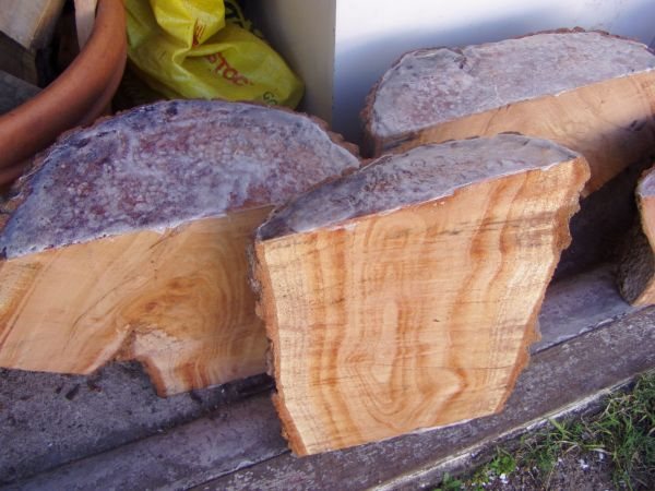

Originally posted by Darley
<br />
Serge
Here's another photos to show you the seal. I do the seal with petrol or you can use turp, you take a jar or a tin cut in peices some foam box ( type tomato or brocoli ) pour the petrol or turp stir and let disolve then put the paste on top of your green log.
Serge

Serge,
&gt;&gt; I do the seal with petrol or you can use turp, you take a jar or a tin cut in peices
&gt;&gt; some foam box ( type tomato or brocoli ) pour the petrol or turp stir and let disolve
&gt;&gt; then put the paste on top of your green log.
What is a foam box? I guess I am not familiar with that term. BTW, did you mean "tin cup", instead of "tin cut"? Just wondering on that as well.
Cool idea, thanks for sharing!
Dale

Foam box are polystyrene box, green grocers have vegetables in it like tomato or brocoli, usually they throw them away, the box is white.
"" you take a jar or a tin, cut in pieces
some foam box ( type tomato or brocoli ) pour the petrol or turp stir and let disolve ""
Sorry forgot the coma between tin and cut
Serge
