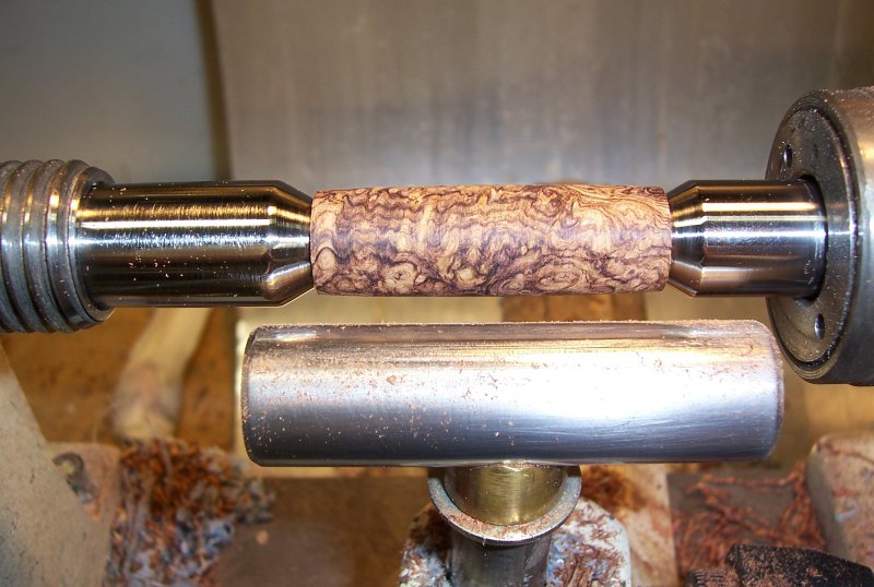

I have found over time that the easiest way for me to apply ca is to put the blank between two 60 degree centers as shown in the photo below. Once I am happy with the diameter of the blank I no longer need the bushings and when applying ca I will check the diameter with calipers.
In the photo a blank has been turned to the desired diameter and is now ready for ca. With a little neatness hardly any ca even touches the centers, what does is easily removed by a razor knife. You may like it!

Thanks George and Gary! Until I get another 60 degree nose cone I will use the wax.... Thanks Again!
I know some poo poo the idea, but I also turn the blanks this way as well. You can't crank down on the blank, but you'll never need bushings again.

I only use the bushing to get in the ballpark and check final size with a caliper.
