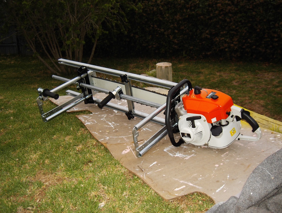

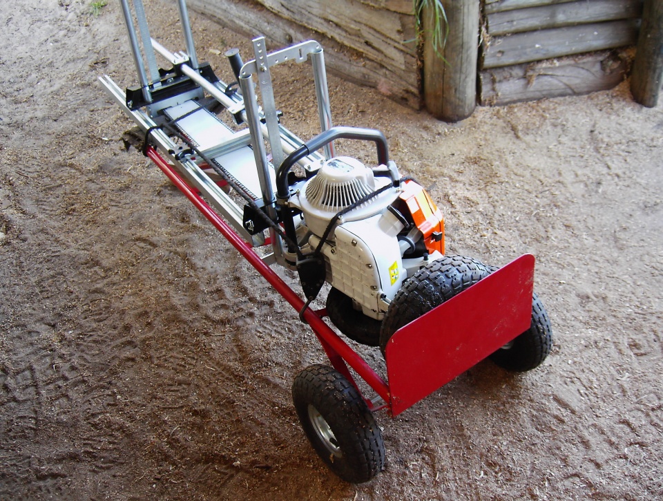

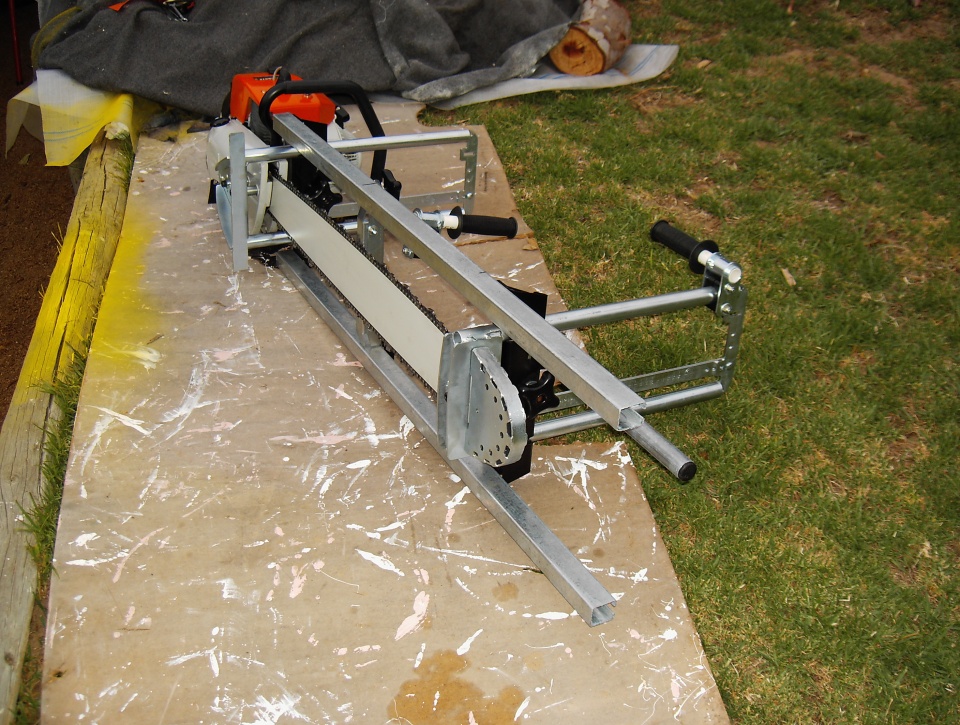

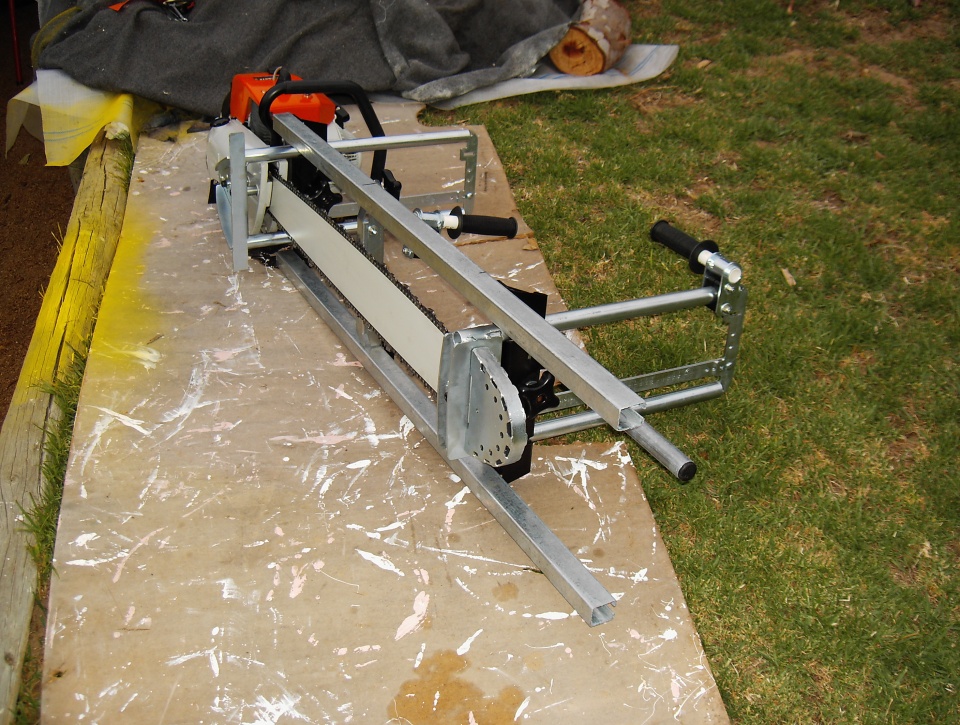

I don't have a sawmill per se. I just have a 14" Poulan Woodshark chainsaw and a Rikon 14" bandsaw. You don't need an actual sawmill if you only want to produce turning stock, but it would be very helpful if you want to make boards for furniture or other larger woodworking projects.
There are times when my 14" chainsaw is a bit undersized, but it is light weight and easy to handle.
Well, you can mill a fair size log/chunk on a fair size bandsaw, I would say 16" and above, as for milling wood/logs on the ground, and not spending a fortune in gear, you can do quite well with about $1,200 to $1,500, this would included a 44" chainsaw mill frame, and a 36" chainsaw that could be one of those old Sthil N90 style chainsaw but, an imitation made in China.
Sure, you you want to spend $2,000 or more in a Sthil or Husqvarna high end power chainsaws, that would be a better investment if you have really a lot of trees to slab otherwise, one of these 110cc Chinese imitations for about $750 or so, can do you quite well.

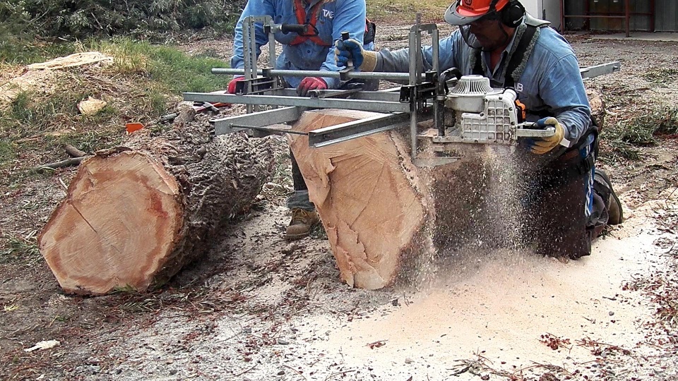

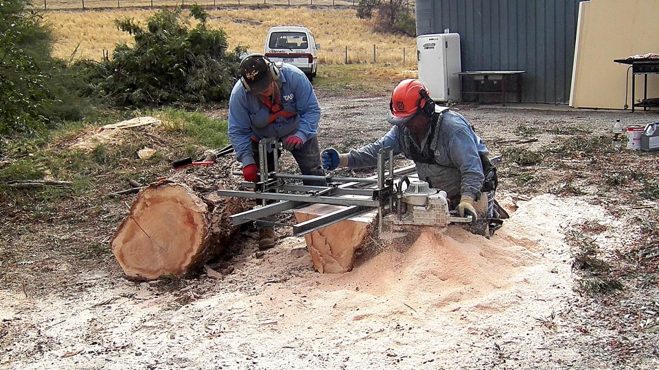

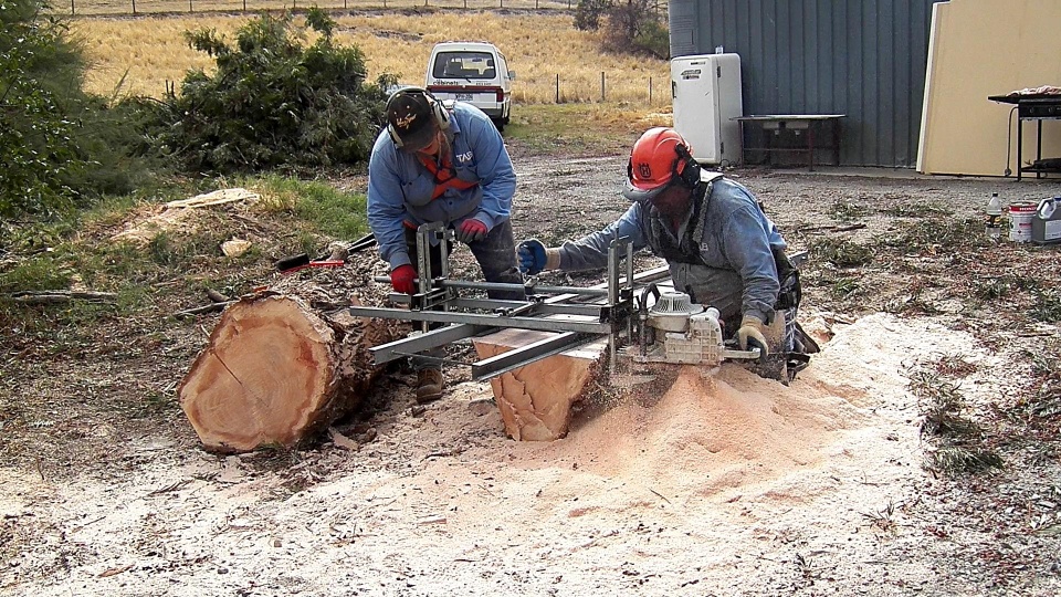

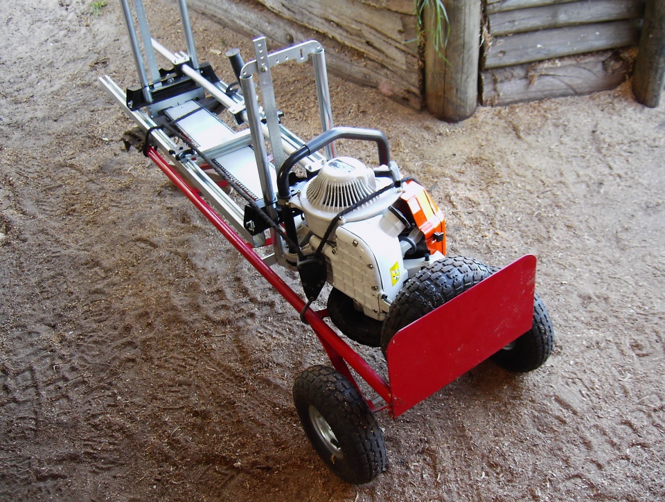

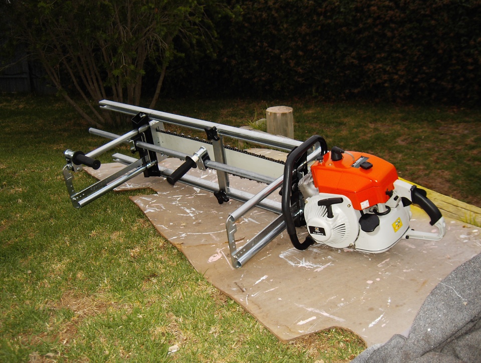

That is indeed what I did years ago when I decided to invest in a portable chainsaw mill, I have done a "fair" amount of work with mine and the chainsaw on its own, when dealing with really large trees, these chainsaws like fuel and oil but, if you look after them, they last you a long time.
I can also say that, before I had a portable mill, I was always winging about big logs that I could slab so, a mill was necessary right..??? well, yes and no, since having the mill often I use a chainsaw to rip the logs into slabs, without any support frames just because, the whole damn mill and big chainsaw is too heavy for my likings and sometimes setting the rails for the first cut, is just a pain in the "posterior"...!
Another thing that I have found was that, some of the logs I slabbed because they were straight, wide and of good wood, they were cut into slabs at least 2.4 meters long and I find myself cutting the slabs into 10" to 12" lengths because that is the size the best suits my needs so, I could have left the logs long, as cut them as I needed them or, cut them in the paddock at about those log dimensions and make it all, a lot easier to handle.
Sure, cutting a large trunk into slabs of 2" to 4" thick, and spaced with some sticks, will accelerate the drying process a lot more than if left in full size however, when cut into 12" or so logs, those can easily be ripped with the chainsaw on site if necessary, making the weigh half and allowing the wood to dry as fast as the slabs would.
Chainsaw mills, are very tough on chainsaws, unless they have sufficient power and torque, they simply blow out/don't last...!
PS: The first pics are of my set-up, just before it was used and the last 2 pics are from the last tree we cut and slabbed, a Silky-Oak done in Easter 2014

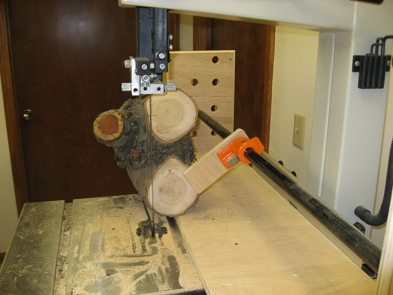

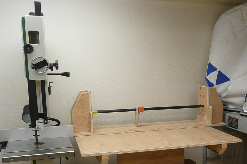

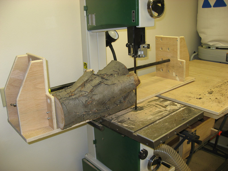

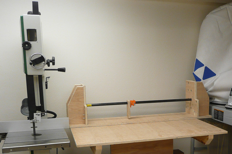

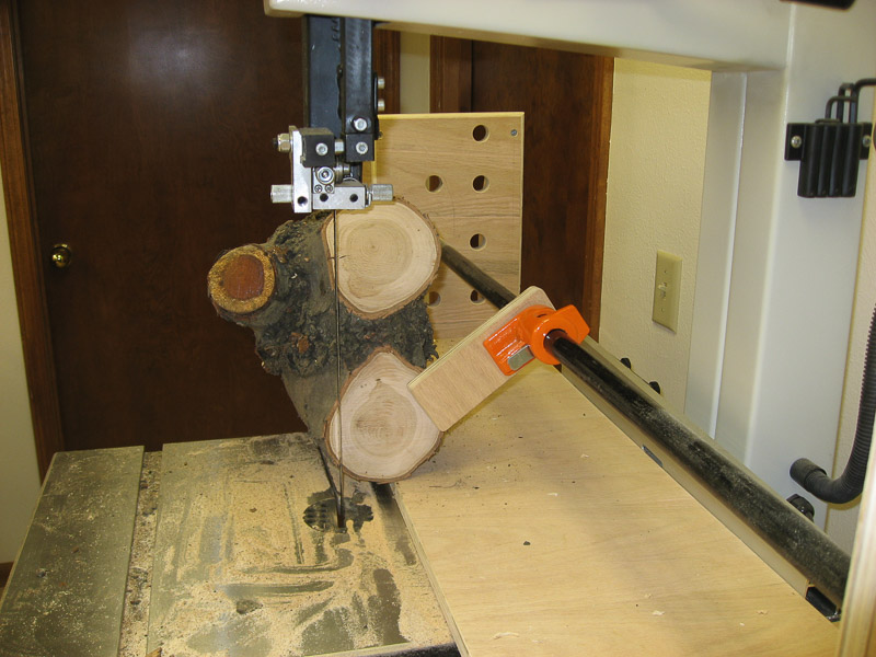

Based on several designs from the web, I built a sled to hold logs for milling on my bandsaw. It uses a pipe clamp as the main hold-down, pressing the log against a couple of screw tips. I have no trouble cutting logs up to 12 inches in diameter. Of course you need an outfeed table for this to work.

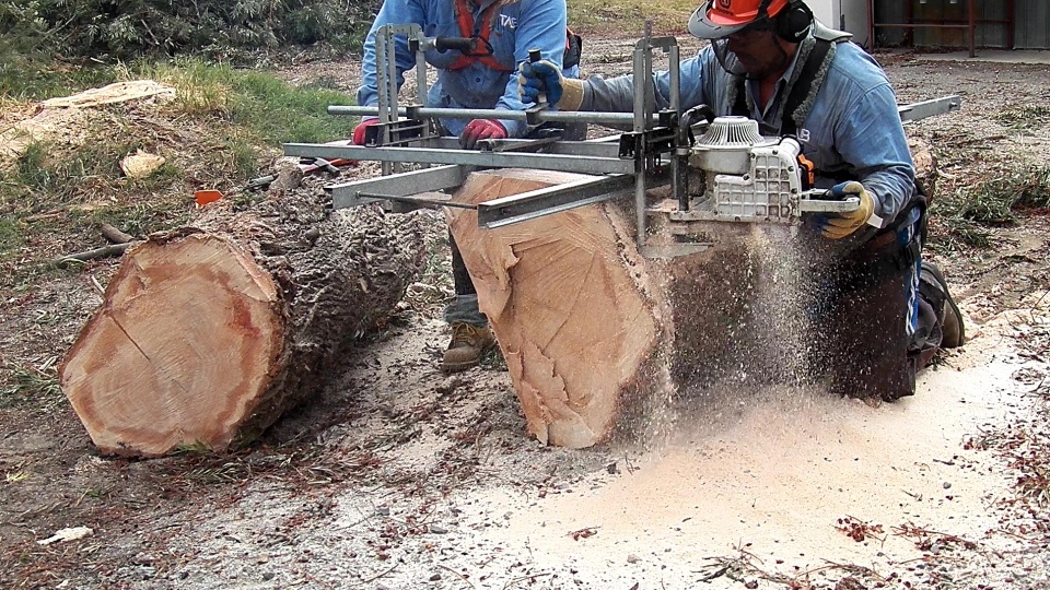

I've considered the Northern Tool el cheapo chainsaw mill for my 20" Craftsman. They've got the mill attachment on sale for $170 right now.
Thanks Dave - that's exactly the kind of thing that I need to build for myself!
