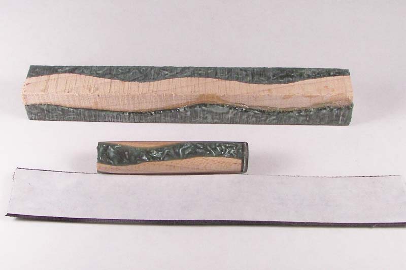

This is my first try. I have done some pretty nice ones since, but have not taken pics. I have also done two different woods. They seem a little easier than wood and plastic. I did one that was maple and black and white swirl from Pipemakers emporium that looked great. I make mine four alternating sides. I use a bandsaw.
