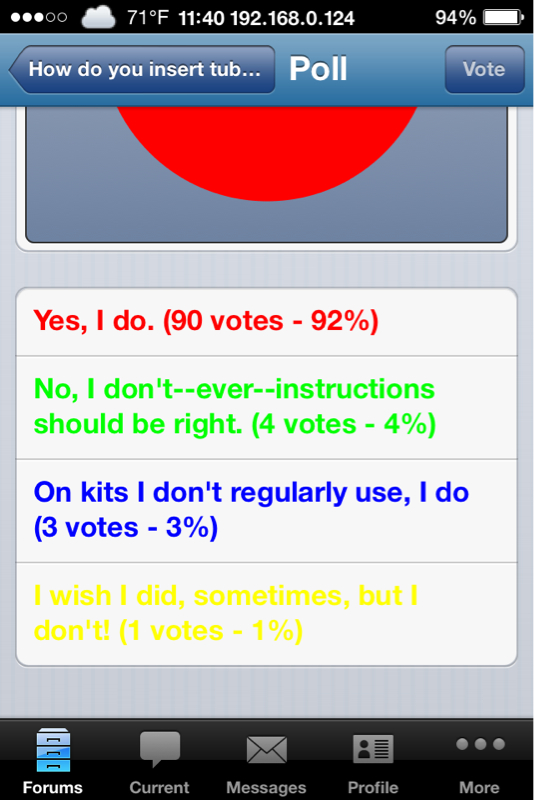

How do you insert tubes?
Do you test fit tubes before applying glue?
  • Yes, I do.
    Votes: 106 92.2%
  • No, I don't--ever--instructions should be right.
    Votes: 4 3.5%
  • On kits I don't regularly use, I do
    Votes: 4 3.5%
  • I wish I did, sometimes, but I don't!
    Votes: 1 0.9%
  • Total voters
    115
  • Poll closed .

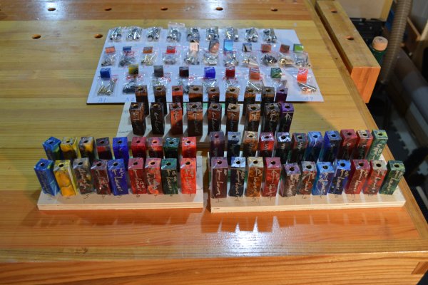

I voted "yes," but it's more because of my method of organizing a "run" of pens. I made a few racks (boards with finish nails) that I use to keep the upper and lower blanks, plus tubes, all organized. The system wouldn't work if the tubes didn't fit in the holes.
