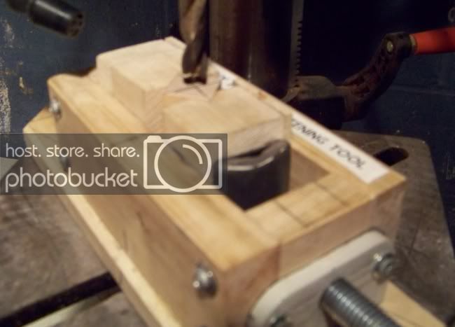

I was lucky a buddy of mine built me a wooden vise using v blocks. I have drilled round stock easily with this. I never have had an issue with the blank riding up the bit using this. I also see guys that use a wood workers vise cut V notches and use that. Holds much better imo. Before I had a drill press vise that was metal and made my narrower V blocks. Hope that gives you some ideas.
Obviously there are drill press vises for pens starting at $50 but there are cheaper methods which seem to work just as good for me.
todd can you post a pic of your vise, mine is very crude and i would like to improve on it
Ryan I sure can. I will try to remember to take a picture tonight and post it. It's a pretty simple design none the less. Will be a couple hours before I can post it.

Ok here are the pictures. My wife took them, nuff said lol. Should be able to get the idea though.

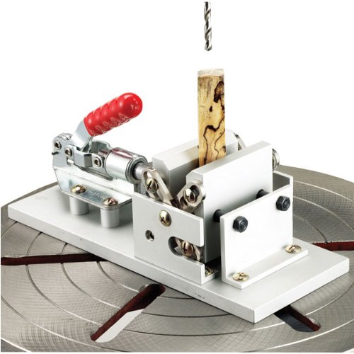

Hi Ryan
You should be able to get on of these in the US...!
Cheers
George
