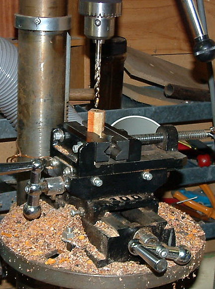

I use a drill press and DeWalt Extreme 2 7mm drill, have drilled many hundreds in Corian. No breakout, nothing under the blank fast speed in fact have never altered the speed.
Having said that initially I replaced the bearings when I bought the drill (Taiwanese bearings?) with quality bearings. Replaced the chuck after reaming where the chuck mandrel fits. Fitted a new chuck that has a threaded back entry and fitted a threaded shaft to hold it truly in position.
Spent two days exactly lining up the shelf to stem to everything parralel and square, fitted an XY movement vice with two vertical triangle cuts in each jaw that match removed any looseness in the gib ways and at the handles.. the jaws have a horizontal vee in each one as well.
I dedicated this drill solely for pen blanks. I drill by eye centring and find I lose one every now and again, but uneven out of square wood blanks I cut initially to follow the grain, they drill easily and well.
Enclosed a pic taken some years ago. I have drilled thousands usually do a batch of one to two hundred at a time.
Have success. Peter.

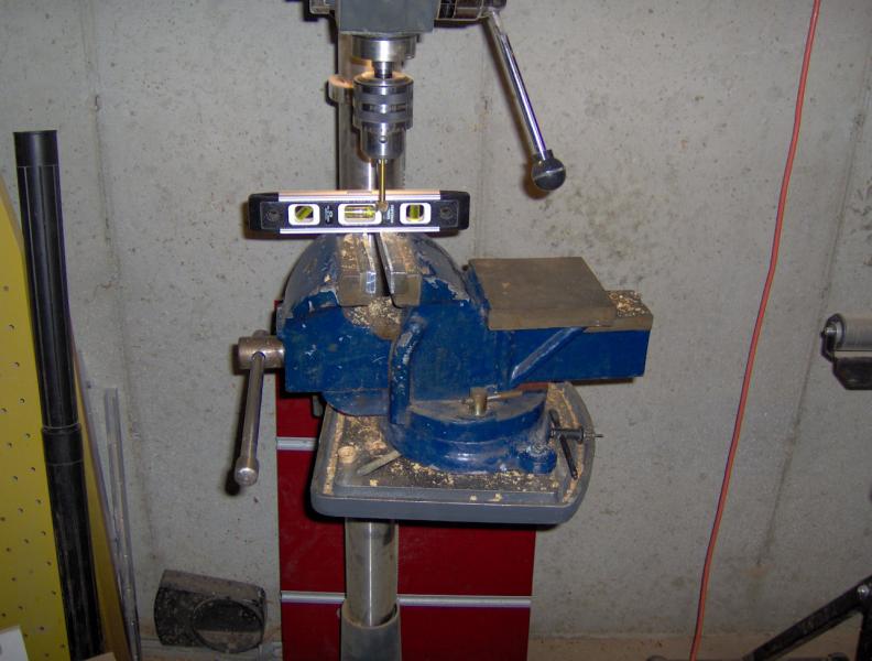

Well. this ain't fancy.... but it will work. Since you have a vice, use a center finder to find the exact center of the blank (this is critical because you don't have much meat to play with). FIND THE CENTER ON BOTH ENDS. Drill about half way through the blank, and then flip it upside down in the vice and drill the other half.
Be sure to dry fit the tube into the hole before glueing up. With this method, occassionally you may have to run a rat-tail file into the center of the blank.
I've done this many times with success.
This ain't the best way, but with a corian blank (some "other brands" of "Corian" are actually a little less that 1/2 inch) that will put the "runout" in the center of the blank and medium (gap filling) CA or epoxy glue will fix any issues.
