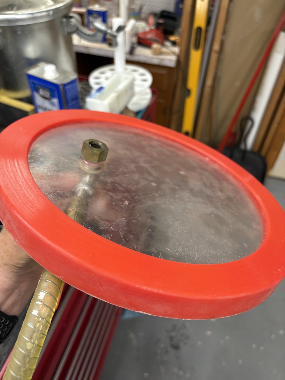

I have done a miserable job keeping my vacuum tank and top clean. The top is clear so you an observe the bubbles being pulled from the wood. I have a stainless steel tank so I cannot observe through the sides. Over time the uncleaned off Cactus Juice has dried on the top and I cannot see through it to observe the bubbles - Is there any way to clean it off and restore visibility?
Plastic definitely has an expiry date when used for stabilizing with Cactus Juice. I would buy a glass cover and replace the plastic one. Glass is much better for this purpose.
Most of those are micro-fractures caused by the cactus juice fumes reacting with the plastic. I know this by experience and eventually will need to replace with a tempered glass lid as well

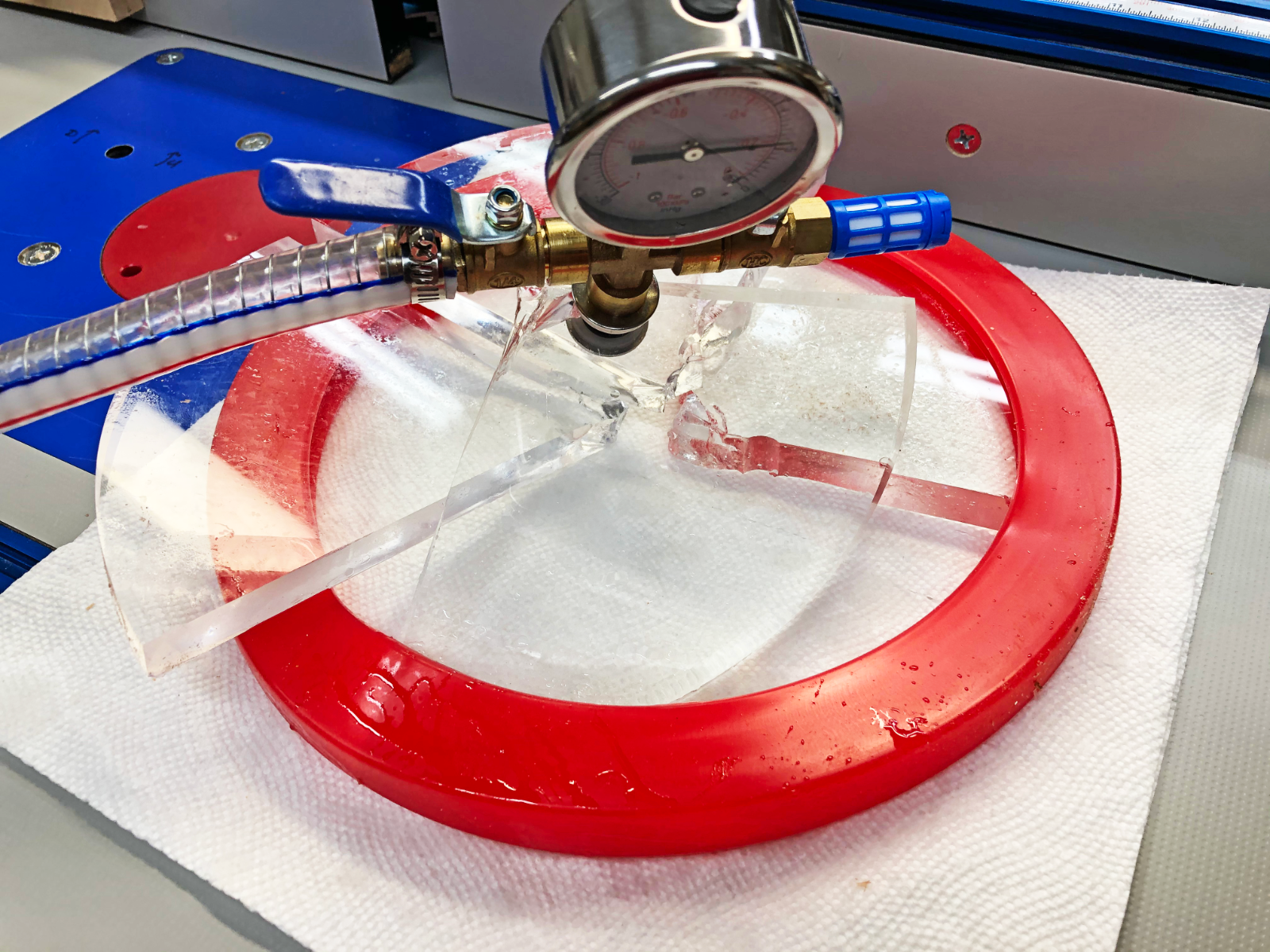

Although many, many members are successful with plastic lids, even really good ones still scare me to death.
My first vacuum chamber was a stainless steel pot with an Acrylic (Plexiglass) lid. There was a hole drilled through it for the plumbing to go through (supply/exhaust, gauge, etc.). On my second use the lid imploded. In addition to the big "Bang!", It knocked my vacuum pump off the table, busted the vacuum gauge, and splashed Cactus Juice on the floor, on my pump, and on a bunch of other stuff. The experience almost soured me completely on home stabilizing.

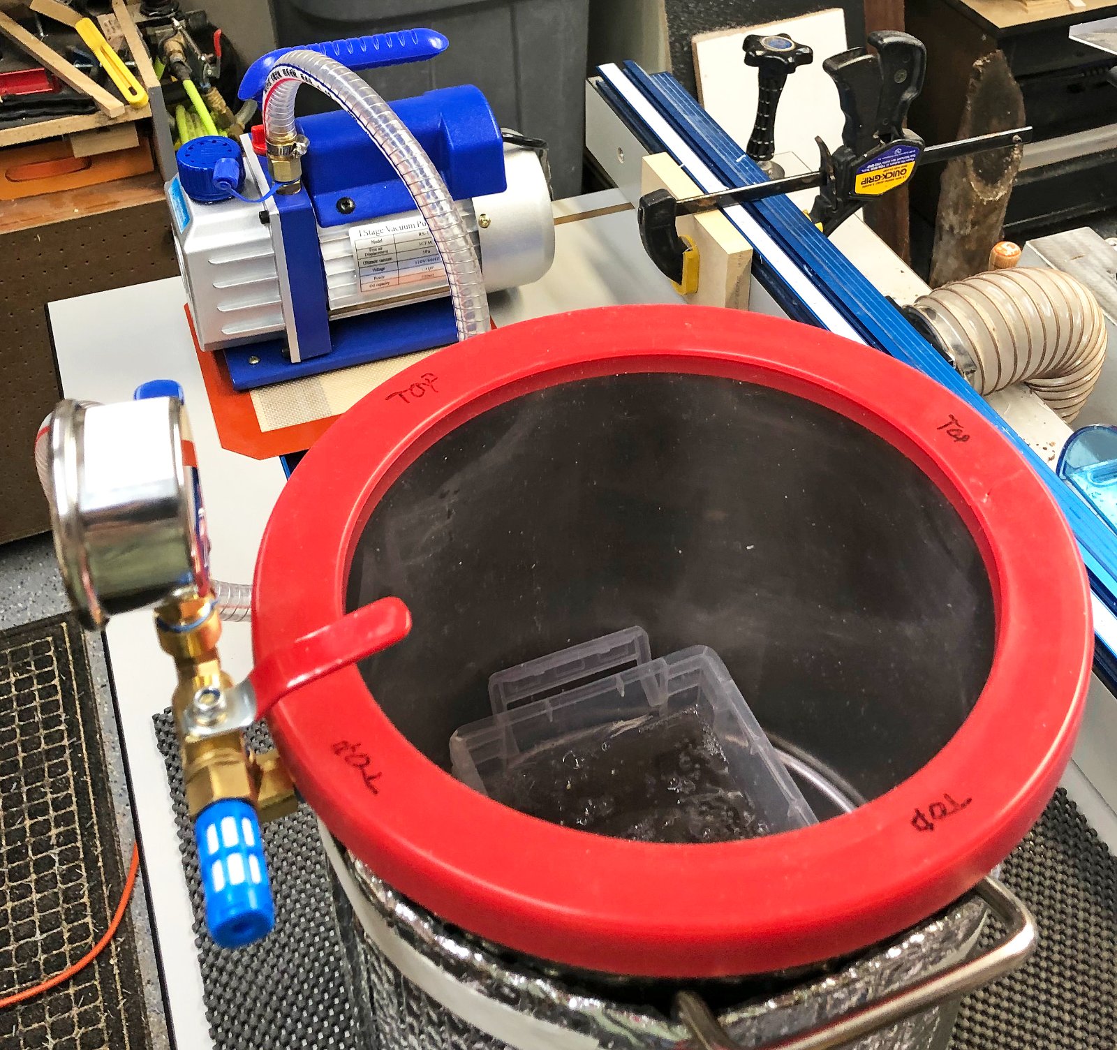

What I wound up with was a tempered glass lid with no holes drilled in it. To get the plumbing into the chamber, I drilled a hole near the top of the stainless steel pot. It is a much better and safer arrangement since holes drilled into plastics are usually inherent points of weakness.

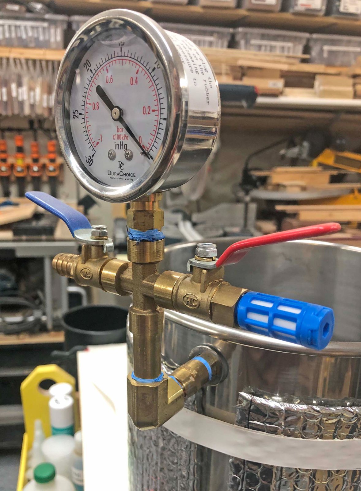

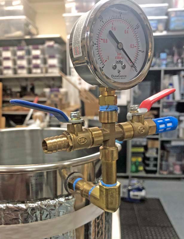

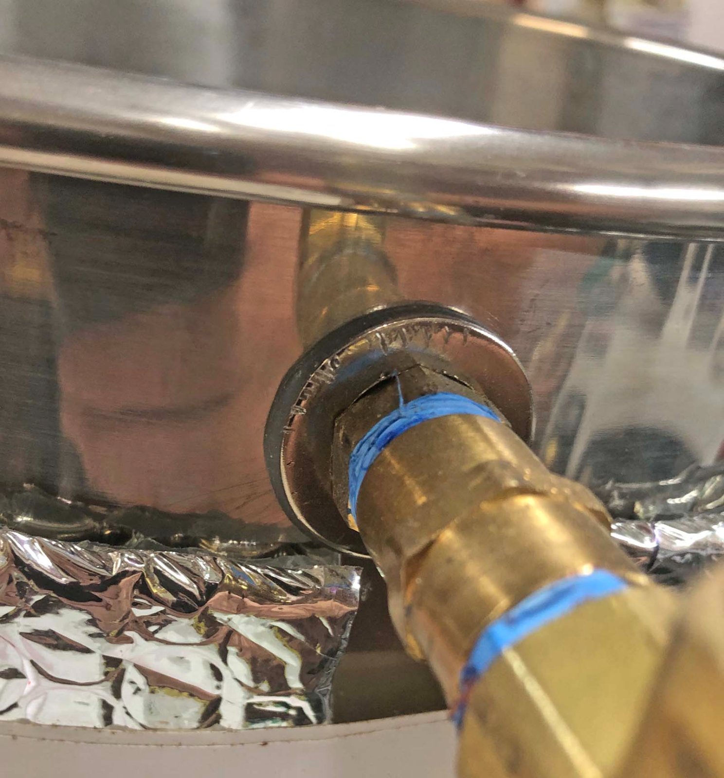

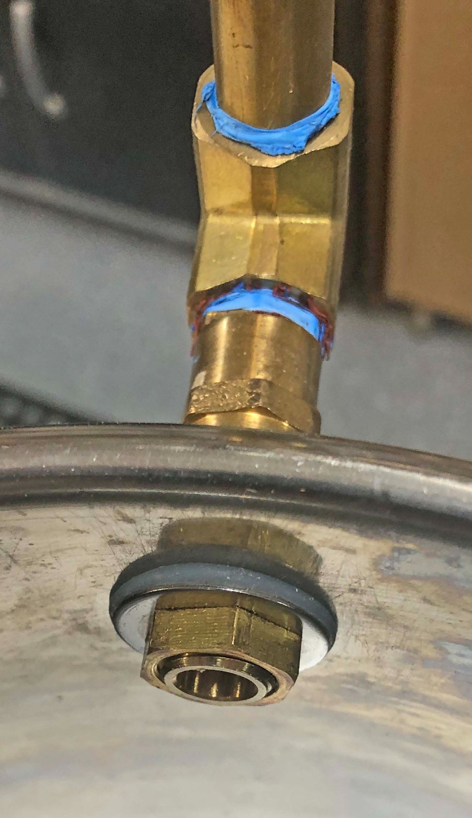

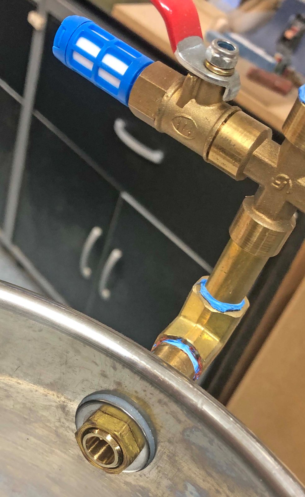

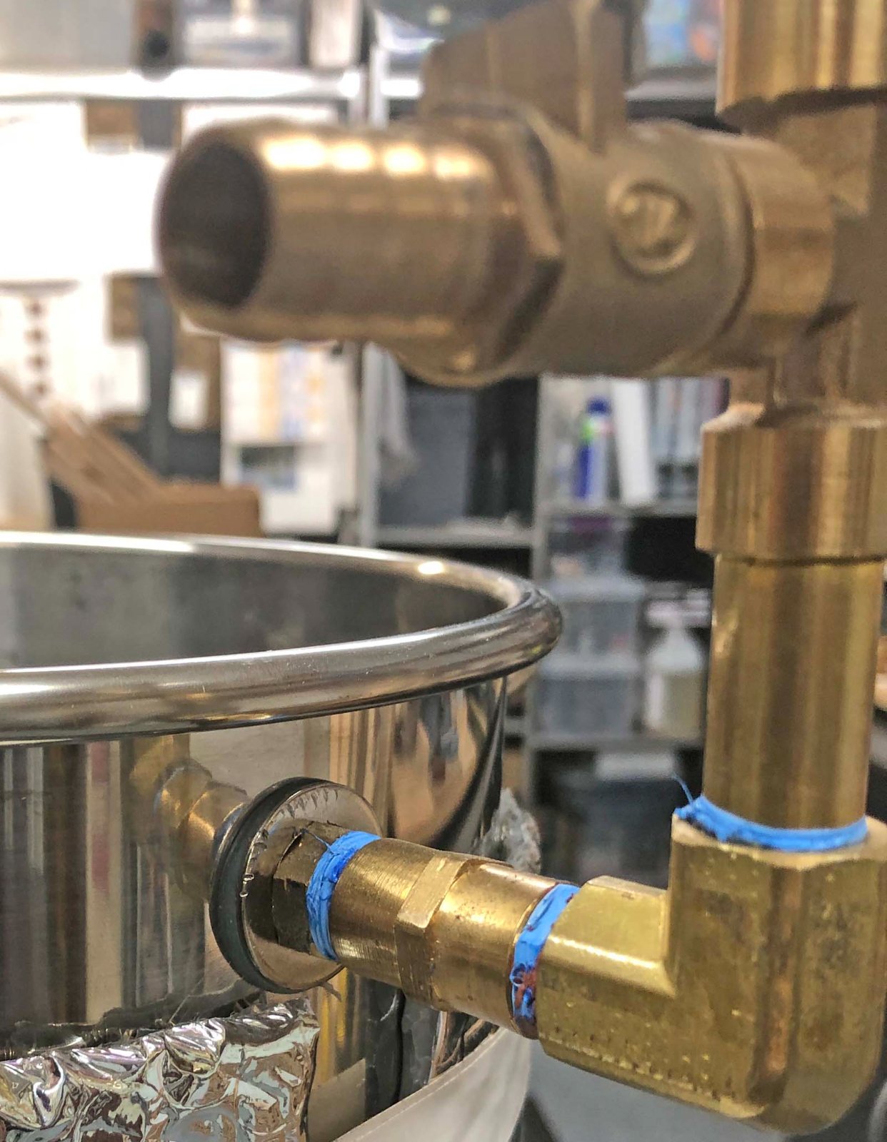

can you post a pic of the side of the pot where this rolled the hole for the plumbing? How did you seal that off?

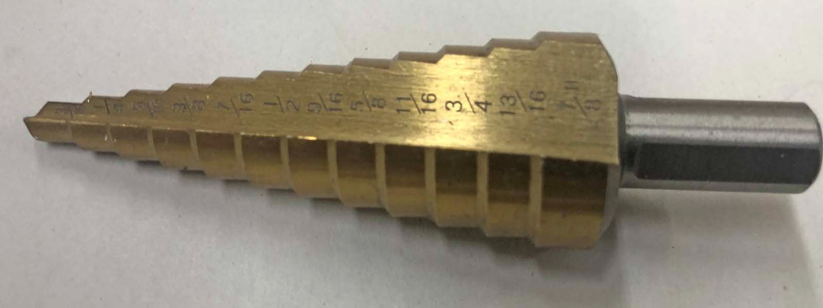

Here are some pictures. I drilled the hole pretty close to the top of the stainless steel chamber using a step drill bit made for drilling thin metals. The plumbing was essentially re-used from the original along with some extra fittings and stuff that I picked up at one of our local hardware stores. (the blue thing is just a muffler to help cut down the noise when I let air back in with the red handled ball valve. If I remember correctly, the gasket material I used between the pot and the big washers were large rubber washers that I also got from the hardware store. I think I might have had to drill the washers out a little so they would fit over the fittings. - Dave
PS Since my vacuum pump sits close to the pot I added a thin insulation blanket (foil covered bubble wrap) to it just to insure that the heat from the vacuum pump couldn't heat my cactus juice up too much - probably overkill though since CJ needs to be about 190F to cure.
(Click on the thumbnails to enlarge them)
The Drill Bit:
The hole from the outside of the pot:
IMG_5331 Cropped.jpg IMG_5332 Cropped.jpg IMG_5333 Cropped.jpg IMG_5336 Cropped.jpg
The hole from the inside of the pot:
