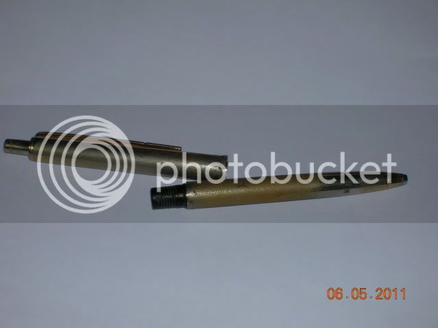

I have a friend and long-time customer who brought me this old Papermate that belonged to his dad, and now is his. It's obviously well used and carries an enormous amount of sentimental value.
I tried to find a similar Papermate to (hopefully) rob the parts from... no luck. So I think I'm stuck custom making this part.

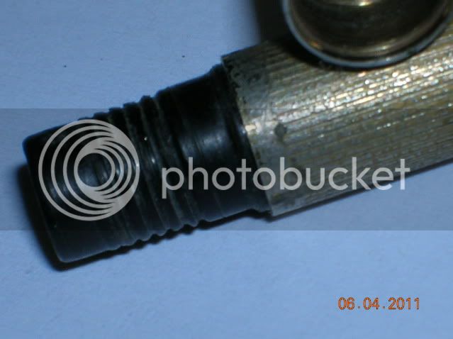

The plastic threads are shot on the lower end. The brass (or brass-looking) threads on the upper end are pretty good.

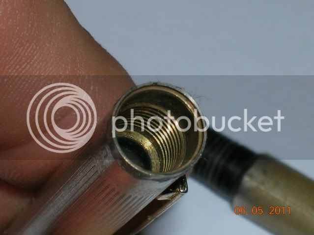

I went to Lowes to see if I could find the thread/pitch, and it's very close to an M7X1.0, but a bolt with that thread cut tends to start for several turns and then seize up, almost as if the brass threads taper in diameter.

It looks to be an unusual thread size; mine measures to 0.276" major diameter and 32 tpi pitch. Very close to 7 mm, but a bit finer than 1.0 metric pitch (0.03125" vs 0.0393") which would account for the jamming after a couple of turns. I don't know that there is a feasible means of reparing the pen without replacing the barrel, if you can find one like it (it appears to be a Slim Profile pen).
Your friend's best option is to just put it back together and retire it to his pen cup where he can see it. :-/

Inside that cap it looks by the photo to be an insert. I'd set that upside down in some boiling water and see if you can get it to slide out. Then I would chuck the pen and spin it down thinner than the threads. Make a new piece of plastic which would be drilled to slide over the existing piece and glued in place. Then spin that down to a normal thread size. Go back to the cap and make a new insert with matching threads to whatever you did to the pen. That's how I'd fix it. But first I would completely disassemble the pen, polish it down with a fine abrasive wheel and have it re-chromed or gold plated.

Jeff, thanks for the advice and I will definitely try to get it out this afternoon when I get off work, good advice. If it's just an insert, I might be able to rig it into a friction fit like our slimlines. I have a lot of brass rod laying around I can work with.
