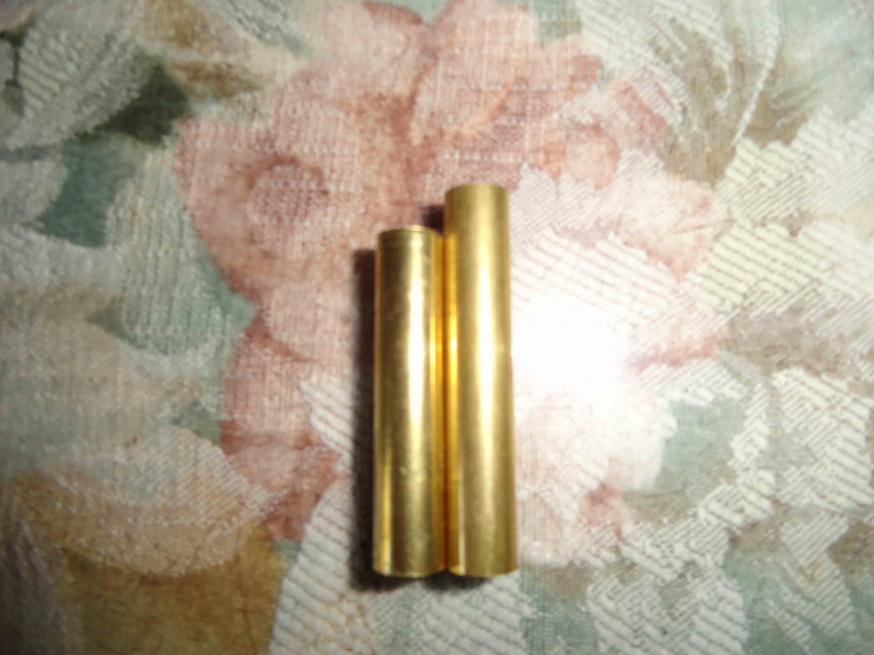

I discarded the tubes I got out of the blanks but I did rummage through the garbage and found one of them. On the left is the Le Roi and on the right one of the tubes from the new Sierra kits I purchased.
