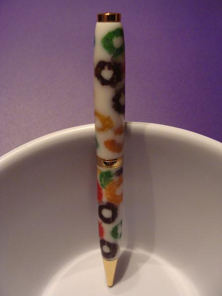

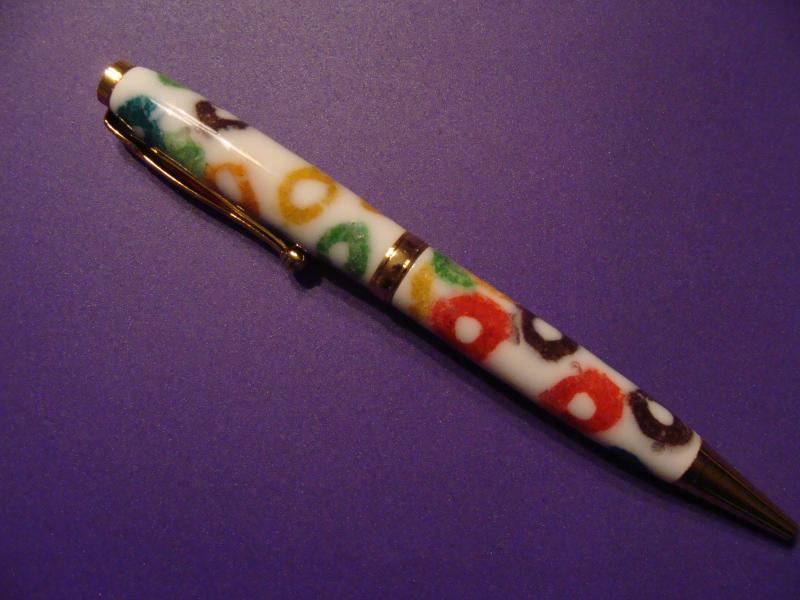

This is a pen I did a few months ago...I just used CA for this pen.
