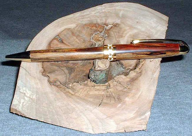

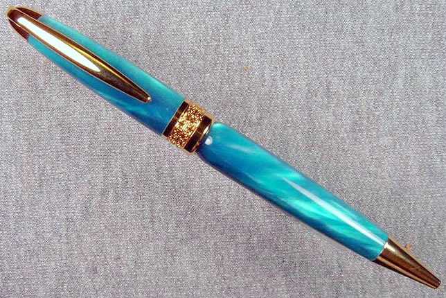

Mike, don't be fooled by the dimensions I posted above. While the PF (short for Perfect Fit) and the Euro are and look similar in size, the Oly uses 7mm tubes and it actually looks significantly smaller than the other two. The lower barrel in particular if turned b2b. The photo below shows what I mean. This pen was turned b2b and kept the stock length.
<b>Image Insert:</b><br />
<br />
The Oly below shows the modification that I believe has a better aesthetic and balance.
<br />
While it's hard to tell from the photos, the lower pen is actually just over 1/4" shorter than the first.
Lee, when I first started shortening the upper barrel I would do so after I had the blank drilled and glued up. I now shorten the barrel before drilling and gluing. I make the cuts on my BS.
