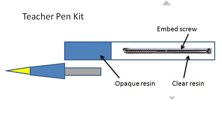

If I were the burl master I wouldn't consider a resin pen, but since I'm not....how about this idea? Closed end twist pen with a very short nib/barrel/transmission/refill assembly and a long closed end cap with just enough opaque area to insert a short tube to fit a short closed end mandrel.

Keep in mind, embedding something is going to bend the light and obscure what the embedded item is. I don't see any way around it though.
