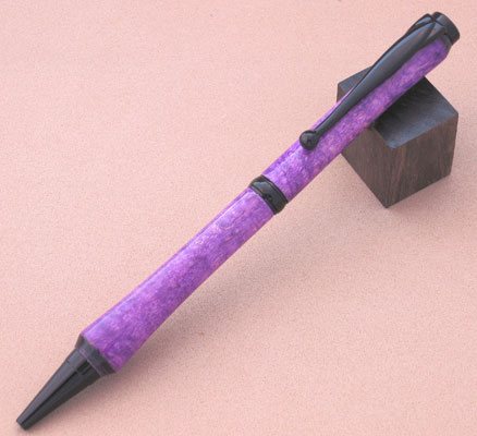

I <b>just</b> finished this pen for a friend. It's lightly curled maple sand and MM'd through 8000. Then, with the lathe on I used a Prismacolor PM-50 Violet art marker over the clank. Quickly wipe the blank with some DNA and finish MM at 12000. A PM-98 Black was used on the tips. About 25 coats of plexi, a black chrome kit and here it is.
This pens are quick, easy and come in lots of colors. I have a boat load of hard maple that I plan on making flag pens - US, Canada and Mexico.
Hope this helps Oh.... I got the pens at Michaels and you can also find them on ebay. Prismacolor double-ended Art Markers.

As for how they work after I got them some colors are good on maple some just look washed out ! But the ones I tried that work for ME are the darker colors IMO now only...only ! with CA over the color they are ok [:D]
The pen above is very nice [^] I like the darker color a bit better but that is nice just IMHO now only [:)]
