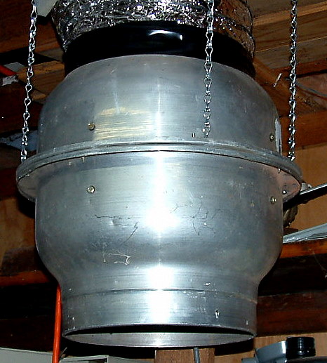

What I have done cheap as a second hand barrell fan or Air Con Duct through fan, minor power cost, efficient air flow to outside vent through the roof with a suitable cover on the vent as my pic shows. I use this summer and winter as well, now our extemes are winter
bit below 30 degrees to summer 100,s.
Kind regards Peter.
