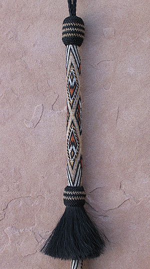

I'm not sure if this is what you are thinking about, but horsehair is used in decorative knotwork called hitching. I would assume that it would not be anymore difficult to do this type of work around a brass tube than it is around a dowel for the handle of a quirt. Would make a heck of a pen if you could find the right person to do the knotwork.
