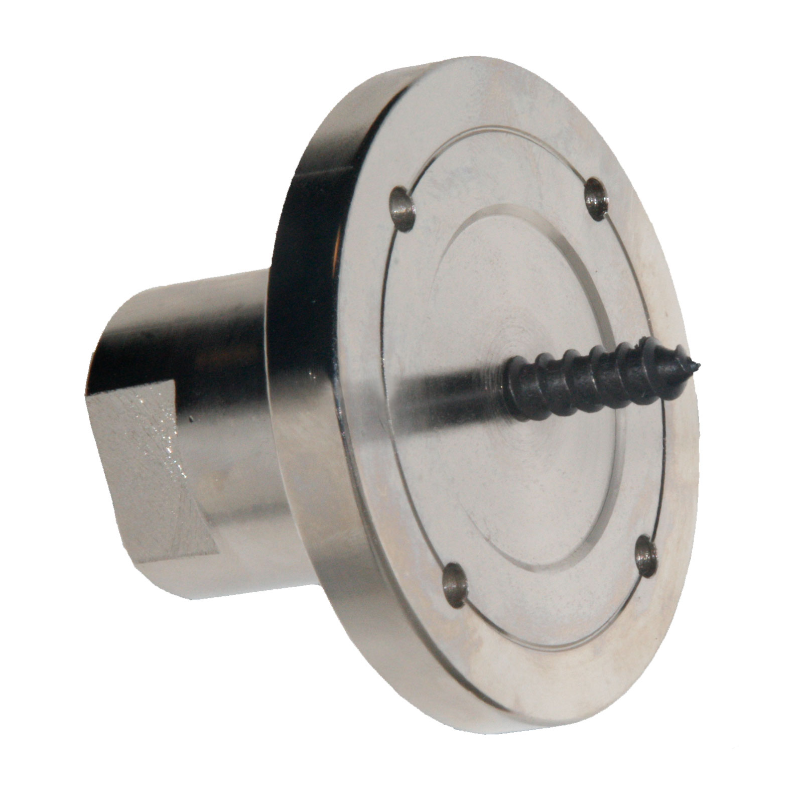

The face plate has *NO* slots or any cutouts to put tooling on to remove them like a wrench or the bar. Neither does the spindle.
This is a face place with the tooling cutouts.
This is a wrench that makes it easy to remove them. This wrench is impossible to use with this model and when I mentioned that to the company I got no reply about it.
