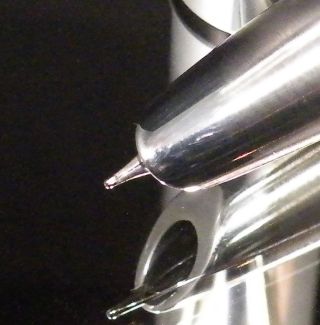

This is a hooded nib
It is a fountain pen where the nib is almost completely covered by a hooded section . The most famous example is the Parker "51" one of the best selling , most popular fountain pens ever made .
