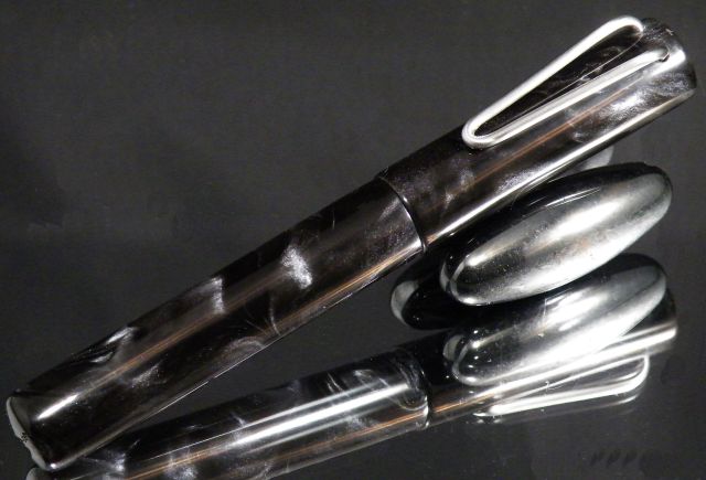

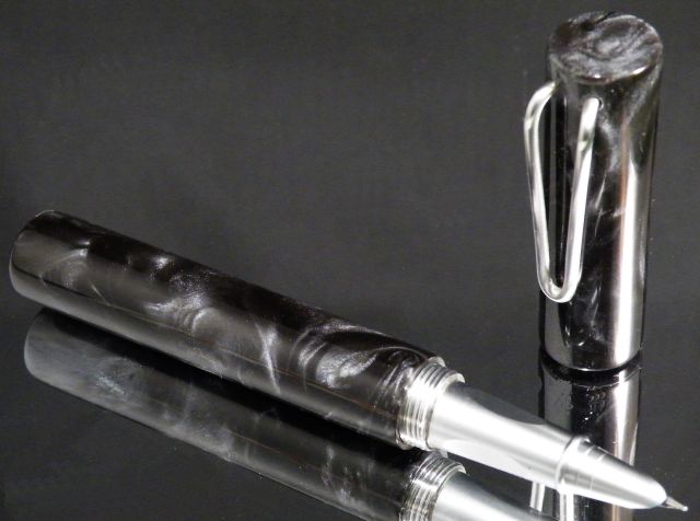

This is a Hooded Nib FP made from some homebrew black pearl PR and some stainless steel and a hooded nib front section from a donor FP .
Pretty basic FP but it writes well . It lays down a wet line for a fine point . It accepts either a cartridge or a converter
As always , comments are welcome .

I've always loved the hooded nib pens like the Parker 51 . I just like the sleekness of them , they look kind of futuristic in a retro way .
The front section comes from a Chinese Jinhao FP I picked up at a local flea market and for a cheap pen it writes very nicely , it feeds well and it feels smooth for a fine point . It has oddball threads so I had to make a tap to thread the barrel coupler . The cap threads are triple start .
The blank comes from a batch that I poured awhile ago that have fantastic swirls in it . I've been saving them for special pens and I thought it would go great with this hardware.
The front section is Anodized Aluminum , the coupler I made from Aluminum and the clip is stainless steel .
Cris , you WILL need a full set of drill bits but the taps are not over the counter . I guess they could be ordered but they would be expensive , and so far the few I have played with the threads are all different sizes ...ALL oddball sizes and pitches . The threads for this one were 8.67 x .7 , good luck finding that tap .
