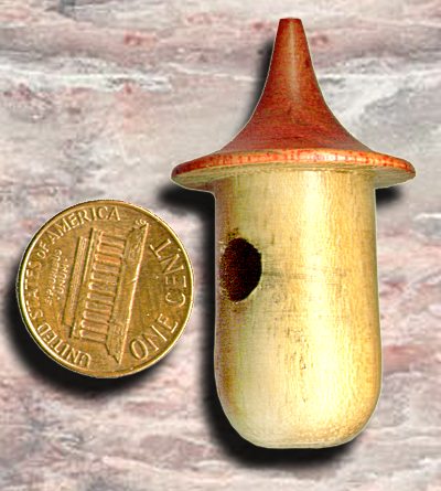

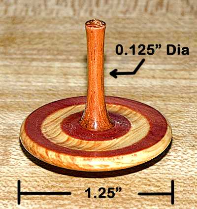

I have found that I can do just about anything I need using my 1/2" skew and 1/4" spindle gouge... the other tools I use the most are my 1" skews and my 3/4" and 1.5" roughing gouges... I have made some real small tops
and even mini-birdhouse ornaments
with them...
