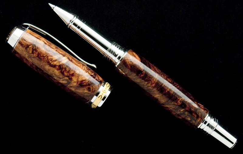

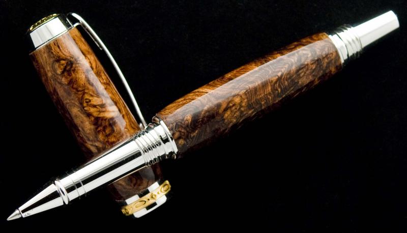

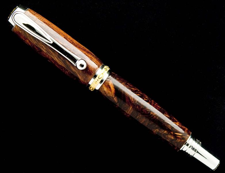

Made it this A.M. It's Honduran Rosewood Burl Eye wood on a 22K Jr. Statesman Rollerball. I think I got a little carried away with the CA finish:rolleyes: Sorry, the pictures look a little dark. Probably will retake them. Comments welcome but most of all thanks for just looking. Doc:smile:

Looking at this pen and being a turner for about a year all I can say is WOW!!! I can NEVER get my finishes to look that good. I always end up just putting BLO on them and then some type of shellac (sp) on them. I have read the processes so many time have tried different styles but no luck. I am very glad that its working for some one. Very Very nice pen love the wood also. Len

very nice depth on the finish...HRB has to be in my top 5 for materials as well, simply amazing what can come out of it!
