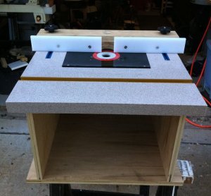

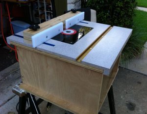

I've been working on a router table lately with the help of my youngest son (16). It's about 90% of the way done so I thought I would show it off a little. The table top is about 22" x 22" and it's constructed of 1/2" Corian on top of 3/4" 7 ply oak plywood. The box is built of that same 3/4" plywood as well. The router plate is a 3/8" thick Rousseau plate that was custom drilled for my Ryobi 2 1/4 hp plunge router.

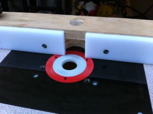

The fence is just three layers of the 3/4" plywood fitted with a sliding fence made of cutting board material from Sam's Club. The dust port is just a 1 1/4" hole drilled at an angle into the top of the fence (cheap but effective for my setup).
Let me know what you think.
