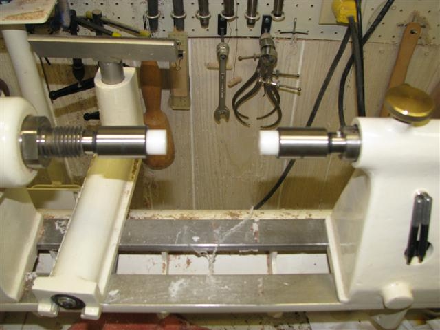

2 MT2 stub arbours with some delrin double sided tape.

I have one simular to Mack C. I use my lathe, I turned a piece of scrap sugar maple to fin in my chuck and the attachec a piece of oak to a #2 MT for the tail stock. I press in using the tail screw. I can't see spending money for something I have already.

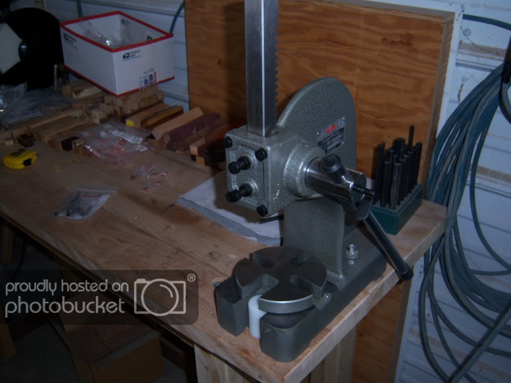

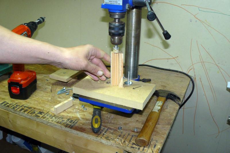

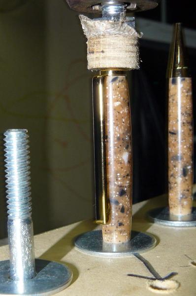

Our is from an old small benchtop drill press.
