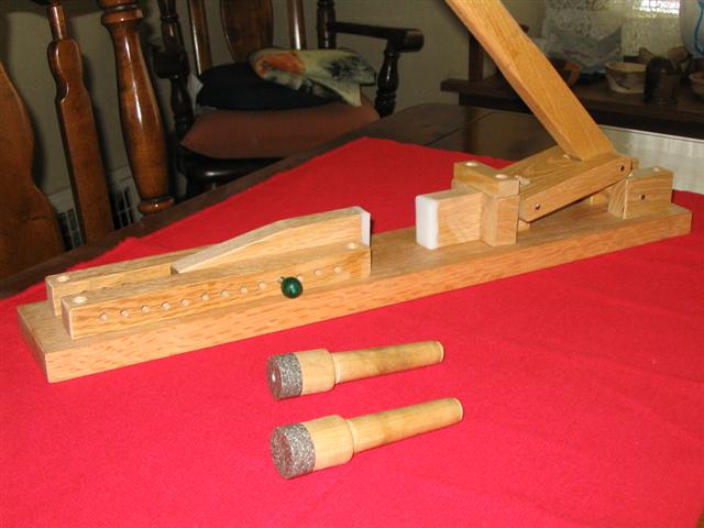

homemade pen press
i altered the anvil or lower portion of the wooden pen press as shown in the photo below. i rarely use it because i use the morse taper pieces in front of it in the headstock/tailstock.
