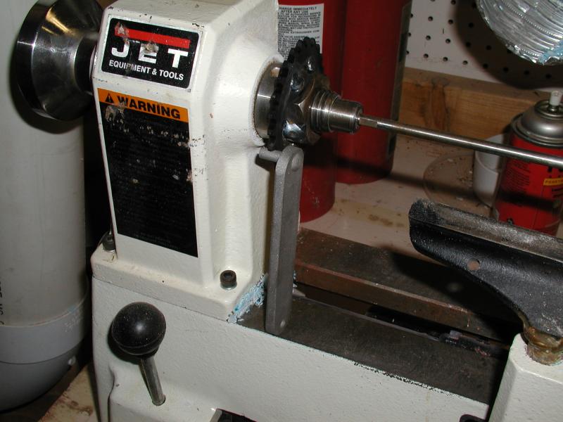

Here is a pic of my latest project. Don't have the base for the pin plate yet, but you get the idea. It is a 24 tooth sprocket, drilled 1" and welded onto a 1"-8 nut that I cut in two. 1/4" rod for the pin. I am also working on an attachment to put holes, or dots, or.... into blanks, and will get to it soon, I hope, and sent out to the beta tester (sorry, already got one).
