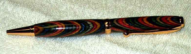

Bob I used the shellac based finish just as stated in Greg's earlier post. I put 3 scoops of shellac, 1 scoop of BLO, 1 scoop of Denatured Alcohol and 2 scoops of Mineral Spirits. The Finish is the highest gloss I've ever had on a pen and it looks like I glazed the wood with clear plastic or something. I applied it by just touching the corner of a cotton cloth in the mixture and holding it on the pen as it was turning on my lathe until the cloth was dry. Then I used a clean part of the cloth to buff the blank and then I applied a coat of TSW. My wife and daughter turned about 5 or 6 more pens this evening and they look fantastic. As soon as I can get a picture to show the gloss I will post it here.
Here is a picture of the cushion grip pen I turned and finished with the shellac brew.

Thanks, Mark! I've used Crystal Coat, Shellawax, and Mylands Shellac based FP's. The Mylands seems far superior to the others so the proper mix is apparently the important part. If you look at the way the solutions separate after standing for awhile, it is quite apparent that the solutions contain differing quantities of the various substances. I just don't know which is which![:)]
That was fast![:0]
<b>Mark</b>, I know this may sound silly but could you also post a picture of your solution in a bottle so I could see how it separates proportionally? I know, just a big PIA! <b>BTW</b>, that looks very similar to a Mylands finish![:p]

Originally posted by melogic
