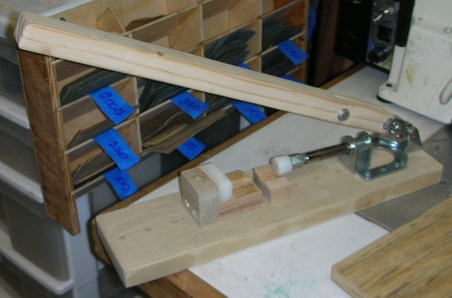

I got tired of the inconvenience of using my DP for pressing pen parts; but the budget wouldn't permit spending $40 for one out of a catalog. After a few Internet searches, I found a used DeStaCo clamp and with some shop scraps, I managed to cobble together a serviceable pen press. It's not terribly pretty; but it works!! Here are a few pictures and I will be happy to answer any questions that the pictures don't.[B)]
Pen Press Prototype with DeStaCo Clamp-Top View
Close-up of DeStaCo clamp. Note nylon hex bolt in the end of the piston to create a non-marring surface.
Close-up of wooden anvil. Anvil is asymmetrical so you can turn it end for end and get some adjustment for longer pens.
Wooden anvil slides between two fixed wooden blocks. Range of travel is controlled by a hex head bolt inserted into one of a series of holes drilled in the base.(see next picture)
Stop bolt in one of the adjusting holes.
Adjusting holes with bolt removed. Note asymmetry of anvil unit
Notice sheetrock screw through the bottom of the anvil for extra reinforcement. In the final version, this piece will be made out of hardwood and probably will not require the extra screw.

Pretty doesn't count. Beauty is in the hands of the user. Seems it might be more comfortable to use if the operating handle was longer, that's easily fixable. Good job. Wonder if anybody has ever converted a walnut cracker, might work.

Randy,
Thanks for the pictures. I couldn't get your concept from the earlier description. Looks like a better press than the $$ ones!

Thanks for posting this Randy, you just saved me a LOT of hassle! I bought bolts to mount the clamp, and was trying to figure out how to make an adjustable base. I was going to use a threaded rod from an old "C" clamp, but was struggling with how to mount it. Yours is a much simpler solution!

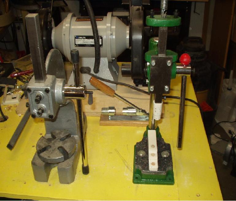

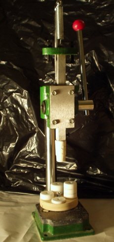

Good job Randy. I tried the Nutcracker, the woodworking vise, various clamps and finally an arbor press. Then got the Grizzly paper punch and modified it. The 2nd photo is the new turret on the paper punch with a Corian ram.

My thanks to all for your nice comments.[:I]
John: I'm curious as to why you went from the arbor press to the paper punch. Seems like they are very similar in function although I expect the PP is a lot easier to move around. [:D]

Frank, right on. Forgot to mention it in the original post; but I do intend to add a handle extension. Just haven't gotten a "round to it."
While I was hunting a DeStaCo clamp, I looked at several nut crackers; but never found one that would have been simple and easy to modify for pen work. Not to mention the fact that most people are pretty proud of their nut crackers and I was looking for an economical alternative. 4 the price of a new nut cracker, I could have almost purchased a brand new DeStaCo clamp.

Hi Serge:
The clamping mechanism was right at $4....bought it used as they are darn near 20 bucks new. The picture probably doesn't show it well but there is a nylon hexhead bolt in the end of the piston that cost the better part of a buck!!! Could have cobbled up a cheaper alternative for an non-marring tip; but that one was laying around from another project and just happened to fit so I used it out of convenience.(alternative spelling = laziness![:D])
