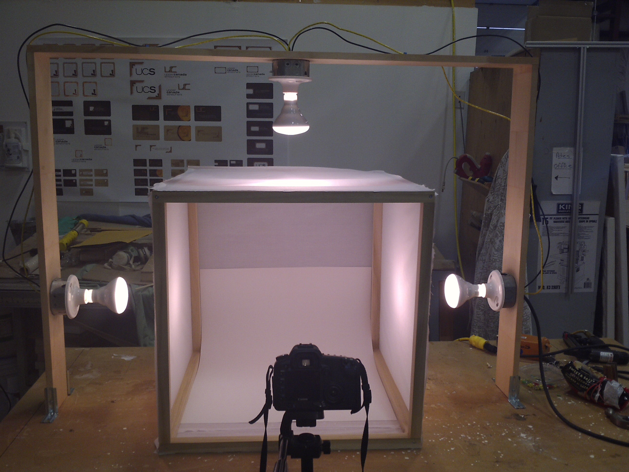

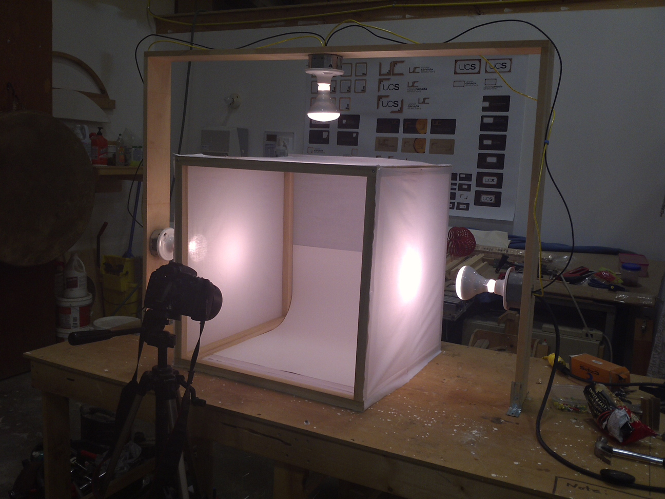

With the help of this forum, as well as another studio photography blog, I put together my own light box. I made a 24"x24"x24" cube, stretched white fabric over it, put a piece of white bristol board inside for the infinity edge, then made the arch piece to connect the light sockets to. I used left over wood sitting around our shop, as well as light sockets, light project boxes, and wiring left overs, so I only had to pay ~$12 for the halogens and ~$13 for the fabric.
The interior is a little larger than some of the DIY's and other light boxes demonstrated, but I wanted something a bit larger for future turned bowls.
For the ability to get consistent high quality pictures, it can't be beat. You're able to control the light temperature by what bulbs you put in, eliminate shadows, use a wider range of camera settings to get swirls/wood grain to show better, etc. Consistency and repeatability, that's its greatest strength; is can be overcast or sunny, you'll get identical pictures. It took me about 3 hours to get the whole thing built.
It's certainly not small, the foot print is a bit big relative to the pens I'm photographing, but I have the room to store something like this. I'm sure I'd be able to engineer something where it can collapse to take up less room, but that's for later.
