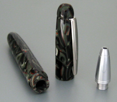

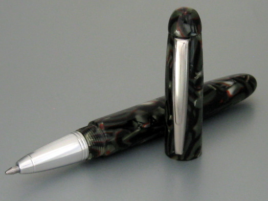

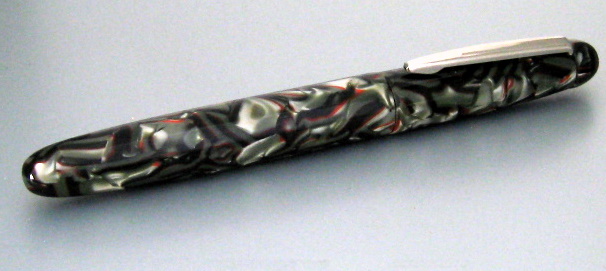

Made this pen over the course of a few days. A friend sent me this blank a couple of years ago. Finally got a pen from it. I'll need to spend more time on these type of finials. This one looked right before I sanded it:redface: As always, thanks for looking.

Nice looking pen! Like the muted hardware with the material. How do the threads feel? I have not tried threading cebloplast, but think it feels a touch "rubbery"...does it connect smoothly or have too much "grab"?
Excellent job, knowing the low melting point of Cebloplast. The taper on the final might need a little work but who am I to say as I've yet to do a kit less.
Thanks Jon. GRAB, is the word I would use. Thought about some kind of lube for it might help. Dunno!:confused:
Thanks Roy. Well, you nailed it. I had to turn the finial on a short piece of cut off and, this was my first time trying this. No excuses, just have to figure it out the next time. You'll see what I mean when yours comes in.:biggrin:
Looks really nice Chuck..I like the whole thing, especially the nib.
Thank you Jeff. I still have some adjustments to make for the next ones.
OK Chuck, I am going to be the one to tell you what I don't care for on this one. The overall shape including the nose cone are great. Heck even the amount the refill sticks out through the nose cone looks spot on. What I don't care for is the roundness from the body to the clip ring and then the roundness from the clip ring to the finial. I think that fit should be flush and smooth. Except for that transition your pen looks vintage in material and shape. I think you should make a section with the same threads as the aluminum nose cone so that your pen can be both a rollerball and a fountain pen. In fact I think you should skip your afternoon nap and do that during the heat of the day since you are going to have record highs. :biggrin::biggrin::biggrin::smile-big::smile-big::biggrin::biggrin::biggrin:
Mike, I always appreciate your critique. The interchangable nib is a great idea. And, you are right on all counts EXCEPT, the part about skipping my nap :frown::biggrin:
Outstanding work. Great blank.
Thank you!
Chuck, I've heard that Cebloplast is a Bit(# to thread, I like every thing except the finial, but I'd still use it and wouldn't feel bad showing it off either.
Great pen Chuck. I love that Cebloplast, and you made a beauty out of it! I was wondering what you would do with it. Can't wait to see it...
I think it looks great Chuck! I do agree with the peanut gallery about the finial, but I've been there and still have to make a few to get it right! I also have JUST enough of that serpentine cebloplast for me to make a kitless. I'm gonna do ALOT more practicing before trying it though. That stuff is pretty much extinct now.
I like the overall look, but if you want to do a finial change, I would be happy to send you a section to work with, I'll get it in your box tomorrow.

Chuck, that's a good looking pen, and a new style for you. I'm with everyone else on the finial but you knew that.
Mike
Chuck, can i ask you why you turned the finial separately from the cap? I turn the finial with the cap so that the diameters will always match up. Just screw the finial into the cap, mount it and turn it as one piece.:biggrin:
I knew there had to be a better way. I just hadn't figured it out. Thanks Justin.
