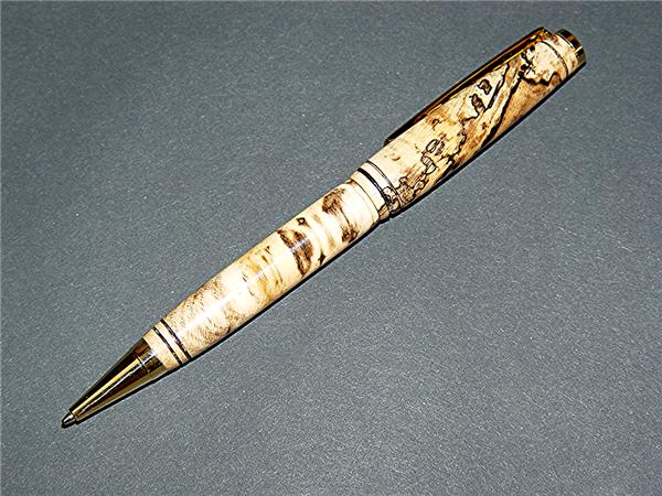

White Holly will age to a light amber color that is similar to old Ivory.
You can also set it aside to spalt and it will look like this.
<b>Image Insert:</b><br />
<br />
Either way, Holly makes a nice pen.
