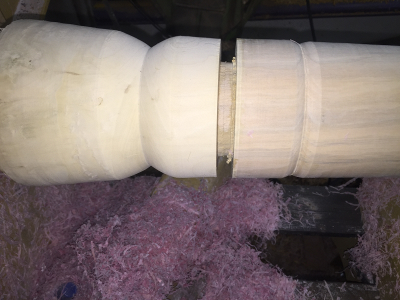

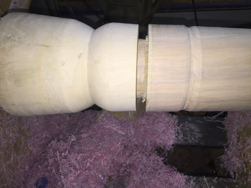

I have done this recently on a piece of holly. left side was bleached, right half is natural. Note that the bleaching is limited to the wood surface (maybe 1/32" penetration) - so you need to have turned to near your final shape, and done most sanding before you start bleaching
