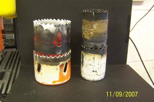

These are the two pairs of similar holesaws, 1 pair for the body and the other for the cap

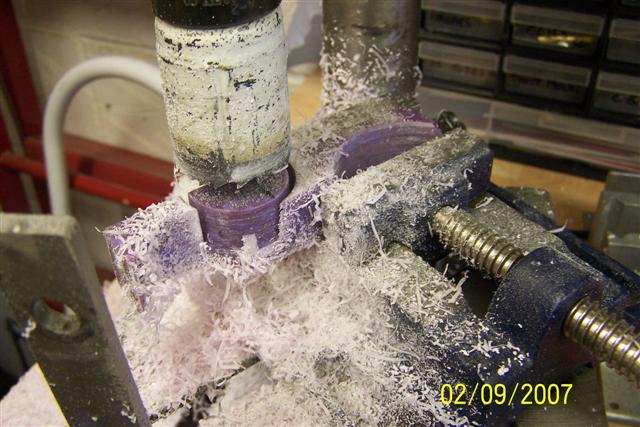

Here I am cutting the segment using the larger holesaw from each pair. I left the pilot bit out.

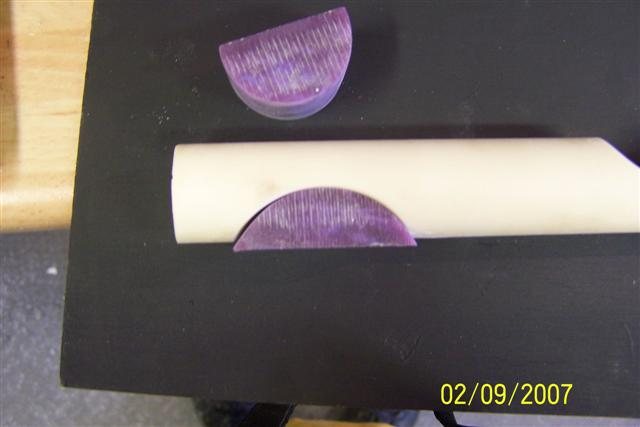

Here you can see that even using matching holesaws, the gap is too big

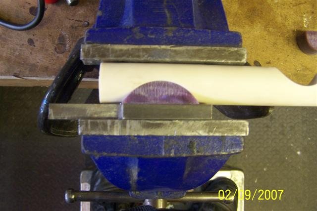

Holding it the vice and heat it up while gently closing the vice. ( I also sanded most of the rough marks off that were caused by the holesaws) The segment was wider than the vice jaw, so I just added the chuck of metal. I concentrated the heat on this bit of metal. Leave it in the vice till it's cold.

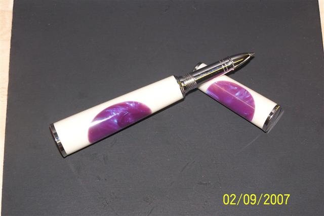

Here's the pen again, no visible glueline:D
