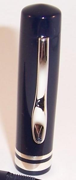

George, Is the clip on this picture custom or from a kit?
Can you please post pictures of your custom clips, if you have any?
That clip is from a Rhodium plated Atlas (polaris) kit.

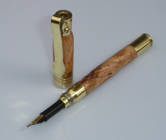

Building your own clip can be fun. You also have to have a way to attach it. Rules don't exist so much when you fabricate your own pen! This pen has a custom brass clip and it does have some flex but not so much that it just bends. The clip was cut to look like an arrow. I sandwiched the brass sheet between two pieces of wood. I drew the arrow on to the top of the wood and then proceeded to cut it out with my scroll saw. After a few minutes letting it cool down some, I then sanded the edges to refine the shape and remove any saw marks. I clamped a 30/06 casing to my work bench. I notched out a piece of wood into a v shape. Holding the clip with some vice grips and wearing gloves too, I used a propane plumbing torch to heat the end of the clip. I place the end of the clip over the bullet and with the notched wood I pressed down, causing the end of the clip to bend around the clip. The idea was to use the back of the arrow to secure the clip. I then drilled two small holes through the clip into the scrap brass bullet to hold the clip in place...the arrow head facing in the opposite direction that I wanted it to be..so it was facing away from me. I found a scrap rod of metal laying around the shop somewhere and mounted it over the clip. I re-heated the brass and pulled it over the scrap rod. Down by the arrow head, I heated it up and bent the arrow upwards a bit, then went back the the back of the clip and heated it up and pushed it down more . Once the shape was right, I unscrewed the clip, then heated it up one more time and bent it just a tiny bit more so that the clip would lay against the body of the pen nice and tight. Using my rotary tool, I polished the clip with brasso to remove all the burn marks from the torch..heck, that's more work cleaning the finished clip than making it! I then screwed the clip into the finished pen along with a couple drops of epoxy in the holes. I realize this isn't the clip you want for all your pens, but I tell you this Alex, to stimulate your imagination as to what you can do by yourself. I am not a metalworking shop. I am a woodworking shop.
