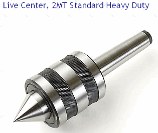

This is the 'live-center' that I use. I purchased this based upon a recommendation, posted, here, at IAP. It might be overkill, but it works great.
<br />
Details:
http://www.littlemachineshop.com/products/product_view.php?ProductID=1592&category=
This center is made from hardened steel and ground for accuracy. It has precision high quality bearings. The point is a 60º included angle.
The maximum diameter of the point is 0.98". The OD of the body is 1.77". The distance from the tip to the front of the body is 1.66".
The rated radial load is 90 lbs. The maximum speed is 5000 RPM.
Part Number: 1592
Weight: 1.48 pounds
Price: $23.95

I had to return my lower priced LC from the LMS and am waiting for my 1592 to arrive.[:p][:)][:p] Hope it is better than my first ones.

Consider one made for metalworking. I've had great luck with centers made by Skoda.
For example:
Skoda MT2 Precision Heavy Duty.
Runout: .0003
Max radial load: 600 pounds (yes, 600)
Both axial and radial load bearings.
Rotating shaft extends the full length of the taper.
Built like a tank. (Skoda also build tanks)
Strong as a locomotive. (Skoda also build locomotives)
Faster than a speeding bullet. (Skoda also build heavy naval guns)
About $50 - $70 at many industrial tool shops.

I just tried out the one I got from LMS, and man what a diffrence. I didn't realize how off center my OEM one was. It was $20 bucks when it arrived.
