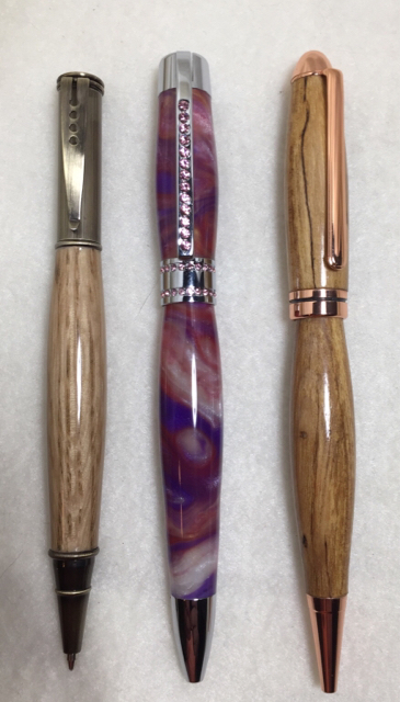

There are 2 very nice slimmer pens on the market I think.
1. Zoe - I think this is the best of the twist options. It does have a crystal in it that can be either a good thing or a bad thing depending on your audience.
2. Tempest - Beaufort ink pen, so you know it's going to be a good one. Probably one of the best clicker pens out there and it is definitely thin.
Depending on whether my customer wants a twist or click mechanism those are my go-tos. Either way is thin while retaining the much nicer writing (in my opinion) Parker refill.

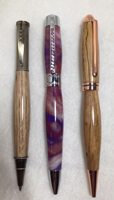

Please, Tim, just clarify what you mean by "slimmer". Both of the kits you mention use Parker-style refills. . It seems that in the OP, it is almost implied that slim = Cross.
The Zoe (Parker twist) uses 8mm brass and is similar in architecture to the Slimline Pro but is more elegant and is a twist pen in contrast to the Slimline Pro. . The Canadian distributor calls this pen the Regal and it is a Dayacom kit and is good quality.
The Tempest (Parker click) uses two different sized tubes requiring drills of 10.3mm and size "O" so it is approaching the Cigar in size and I would not call it "definitely slim" ... but I believe it to be good (as in quality).
They certainly aren't in the slim line family but they are on the slimmer side. The top half of the tempest may be a little chunky but if you turn the bottom straight it ends up feeling very slim in the hand. I think a lot of the issue for newer turners is the tendency to turn fat in the middle. Hold a narrow body the entire way and they are certainly not wide bodied pens.
For the record I'm not implying you can't turn them slim. :) I've just done well with both of those when people ask for a slimmer pen style. I hate slim lines and will admit I'm biased against them.
