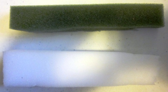

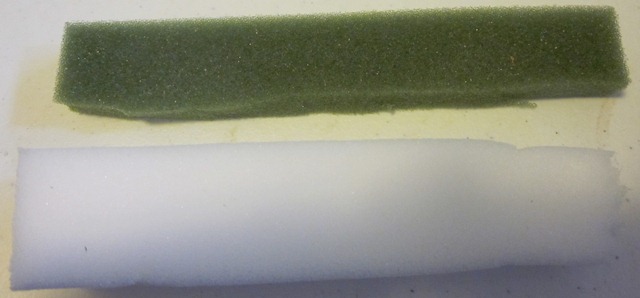

That is how I finish all my blanks!! That foam rocks!! I discovered it about 1-1/2 year ago when I was having trouble with CA finish and trying many things.
Foam doesn't cause any acceleration and creates a very smooth finish!!
Give it a try.
In the alley on the 26th of December.:wink:Where do you get the packing foam?
Sure, here you go John. The green one is not as high density as the white one, and they sell even more dense foam at the places I listed above.
Hope this helps!
