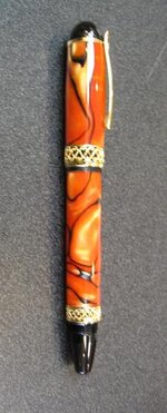

Well, I couldn't hide the crack, so I redid the cap with a new blank that pretty much matches the bottom of the pen. Here's the finished project:

I too have just found those blanks and got them from Ernie. I am working on a few as we speak and are you sure it is a crack. The reason I ask there is alot of veining running through there and what appears to be cracks are just light colored veins ever so thin. I love these blanks because of the light refraction you get off of them. I need to get a few more things done and hopefull have a few photos to put up.
Oh, it's definitely a crack. This was just one of those $3 "acrylic" blanks you buy off the spinner at Woodcraft. Would've been nice to pass it off as a vein, but it just wasn't my day. Fortunately, the new blank matched the old pretty closely.
Out of focus picture, can't tell if the fix worked or not. If it did, congrats.
If it didn't, sometimes you have to accept that 'stuff happens'. Trash parts and start over is often the only solution.
As for giving as gifts, I wouldn't do that. Friends are your best salesmen, giving junk speaks for you and junk doesn't say nice things about you or your skills.
My disasters either end up in trash, as parts or as shop pens where no one will see them.
