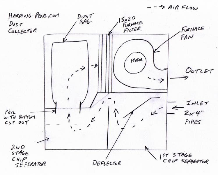

The pre-seperator is fairly easy. You just need to duct the flow into a container to slow the flow down and allow the larger chips to fall out. It is also helpful to point the inlet at a wall or baffle so the large chips hit the wall and loose speed. Many people build these separators from a garbage pail. You can even buy a garbage pail lid with pipe fittings that will work.

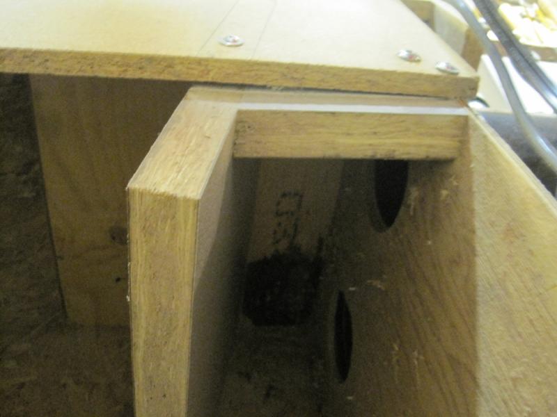

I designed and built my own collector, so I added a two stage version of this separator concept into the filter.
You can see more pictures here:
http://www.turningshop.com/workshop-dc.html
The picture below is looking up into the inlet of my collector. The pipes shoot the air-flow at the baffle as the air enters the first separation chamber. The air flow and multi-stage filtering is shown in the sketch.
