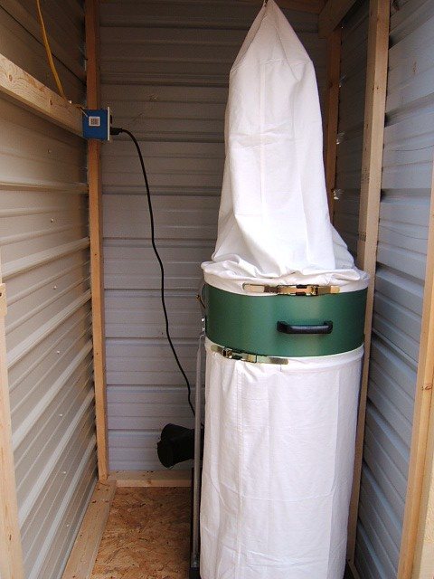

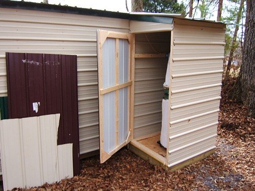

Guess I echo the post here.. I put my HF 2HP DC in an 'outhouse' on the end of my shop. Put a switch on the wall inside so I can turn it on/off from insde the shop.
Right now I have to replace the motor on the blower... it stopped yesterday after I shut down for lunch. Called HF and they are sending me a new motor on warranty... my DC is only about 9 months old... but gets lots of work outs.
