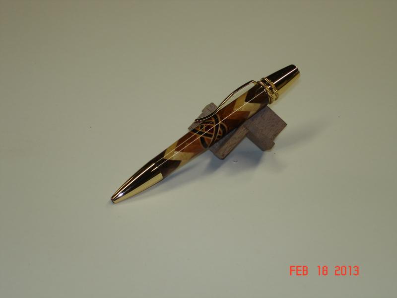

Herringbone 360 with Celtic knot , I thought I would try this since I have never seen it before.

That is a beautiful pen. Great job. The segments look really tight.
My only question is why you didn't enter it in a Bash contest???
Outstanding pen! I love the segmented pens but i dont have the patience for it my self and never could get the segments tight enough for my liking. yours looks flawless. Nice work.
Ken, I do see you are new here. Take a look around the Bash threads. There are a lot of events, and a couple of them are still open for pen submissions. It is a great way to get involved and have some fun.
Thank you all for the good comments on the pen, this is the fifth 360 I have made and after I trimmed the ears off I saw that It was nearly flawless. I got the brain storm then and thought about adding the Celtic segments knowing very well I could be screwing up a good 360 blank by cutting it up four times. Luckily it turned out , thank you again
wow! did you make the herringbone pattern also? looks awesome
Yes I made the Herringbone pattern , this is the fifth herringbone for me , the first four were made of 1/4" x 3/4" x 3/4" to make the glue up easier and less pieces. This pen is 1/8" x 3/4" x 3/4" with more pieces and a little harder to glue because of less surface to keep everything square.I made a jig to glue some of the steps to make the six piece layers and made extra layers so if one didn't fit exactly I could change it out with a different one before I glued them up. Thanks for asking
Ken, You have given us something to shoot for. Not sure I will ever hit it but it sure will be fun to try. I to wonder about a close up. Regardless - reallllllllyy NICE!
I'm not a big "Click-the-Like-button" kind of guy, but you get a 'click' from me one this one! Be interesting to hear the 'work flow details' that got you going on this one?
