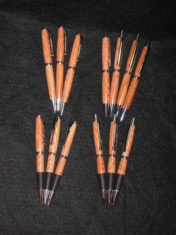

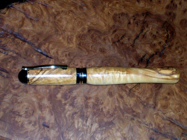

Here's a couple of pics of some pens sprayed with satin conversion varnish. The flash from the camera makes them look a bit shinier than they actually are. They feel buttery smooth but look like smooth, sleek wood rather than mirror-like glass or plastic.
Bethlehem Olive
Plain-jane red oak from a tree that was in a church yard.
