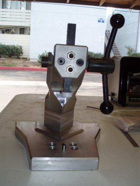

When I had my machine shop, I made about 50 of these little arbor presses for a customer, and I've had this prototype in the bottom of my tool box for about 15 years (Picture 1).

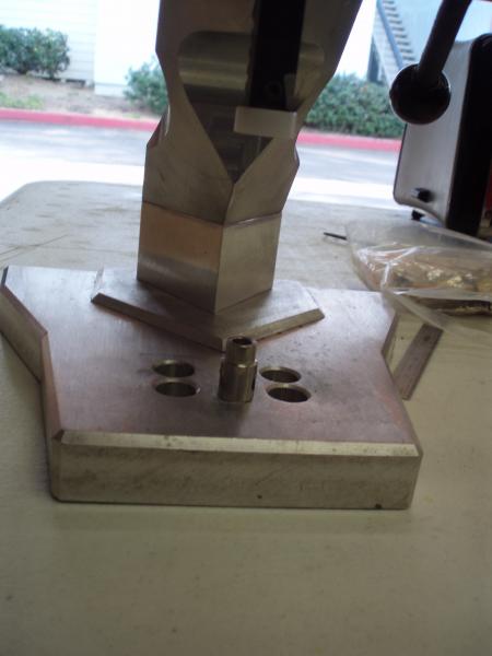

I decided to modify it to use as a pen press, the first thing I had to do was raise it up 1 1/2" to have enough room to press the pens and pencils. (checked the height against a slim line pencil; the tallest I've had to asemble. (picture 2)

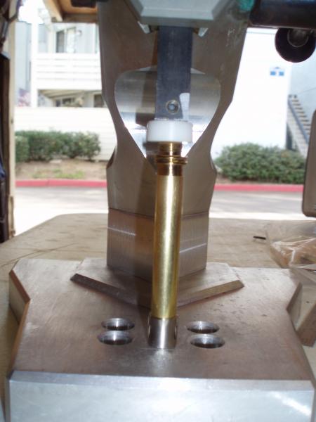

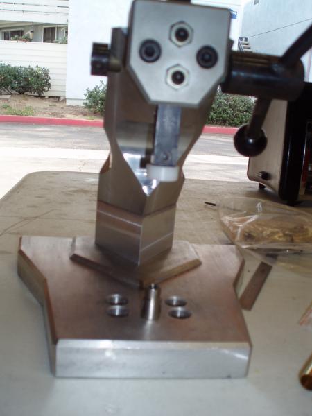

I also made a slip in pin that would allow me to use the same bushings that I turn the pens with as spacers if I needed them. The pin is easly removed if I want to take it out. (picture 2 shows the pin, and picture 3 & 4 shows a bushing on it).

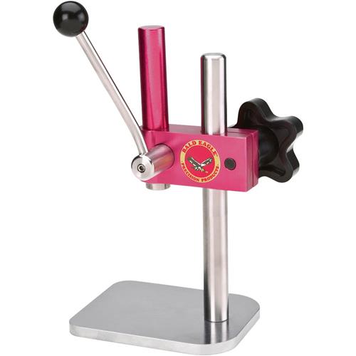

The next picture (picture 5) shows a tube and a coupler in the press together position, using a bushing on the bottom. (I didn't have any pens ready to assemble for this shot, gotta get busy turnning):wink:
You dont have to use the pin or bushing, I just thought it would help keep the assembly straight.

Very interesting.That looks like it would be the perfect pen press.From what I can tell it looks like it would hold everything in perfect alignment.

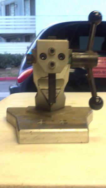

But not to fear there is someone that makes a small arbor press other than HF, Grizzly makes one.
here is the link:
BE1001 Bald Eagle Mini Arbor Press
They don't look too bad and the head looks like it adjust up and down.
